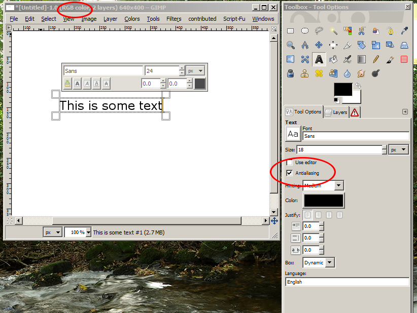

Which exact version of GIMP? 2.8.14 ?
I presume you have your image in RGB mode and have the Antialiasing option checked?:

At this point I think it would be helpful to see a screen-capture similar to mine, with the tool options visible.
I think you need to have 5(?) posts on the forum before you can add an attachment. So If you could make a few more posts, then post a screen-cap back in this thread.
Also, could you try doing what I did:- create a new blank 600x400 image and put some text on it. Does it look pixelated?
