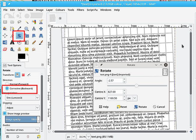

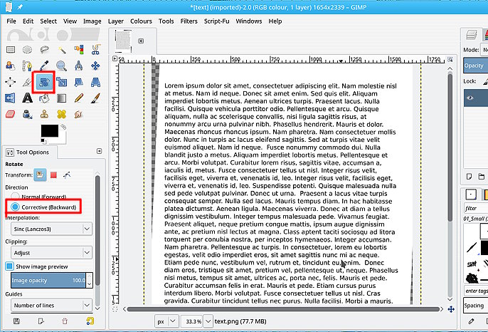

Using the rotate tool - set it to corrective mode and rotate the grid using the mouse. Line it up with an edge or text
applied looks like this.

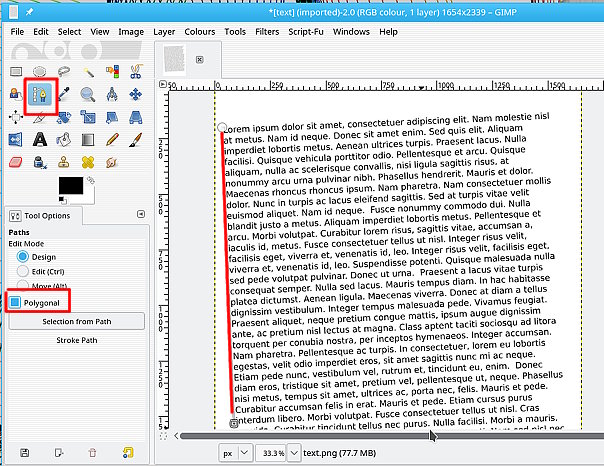

Then there are scripts/plugin aids. Set a path to an edge or text, apply the plugin.
One is ofnuts ofn-layer-straightener.py http://sourceforge.net/projects/gimp-to ... s/scripts/ about 4 down. Un-zip pop into your plugins folder.
Set the path tool to polygonal mode to make it easier.
like this
Result is the same as rotate tool.
