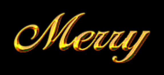

Im talking about this superb goldtext, Wallace posted in the Christmas post:
viewtopic.php?f=11&t=16057&start=100
Im fascinated how good it looks and the many shades it has (like green and dark red, and a desaturated orange)

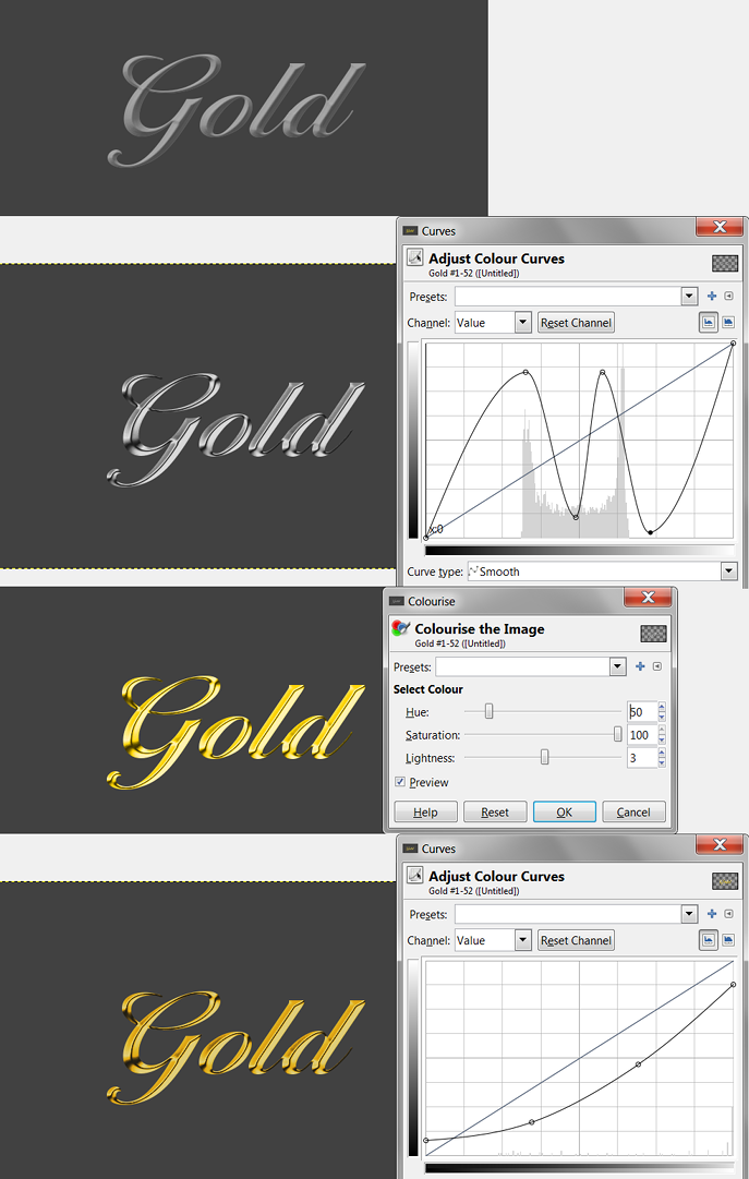

There is a base workflow,
which can help in creating metallic looking text.
It involves the use of gradients,
much like the gradient I posted.
There's also the use of Gaussian Blur on the gradient.
Most important is the use of Color Curves,
to give that metal like appearance to the text.
The colors use in the gradient seem to go from a dark gray to a light gray.

@Wallace:
im familiar with chrome curves.
Thanks for the screenhots. Very helpful !

The christmas text I created was no accident.
There is a known workflow for creating metallic text.
The above images were made with a dark dray to light gray gradient.
The bevel and emboss script us run on it and then blurred.
The color curves was then applied.
Then I used the colorize filter.

Maybe im overthinking the whole thing.
Heres my workflow:
type text in #808080 grey (ballantines 160px)
bevel (with merge down) (Depth 10, Size: 3)
lock alpha channel and blur the bevel slightly (3px)
apply chrome curves
Colourise
apply more curves (Value)
The result is okay, but not as epic as yours...too much black, not many shades, no subtle greens and oranges, wrong goldcolour, etc.

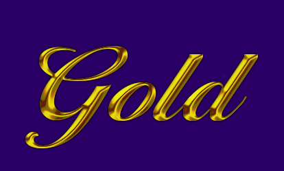

this ones a bit better, but i wish there was a more reliable and reproducable workflow, especially when it comes to the colourising step
Heres my workflow:
You could try using these scripts,
which can use a predefined environment map,
to create gold text.

Okay,
no problem.
As we already mentioned,
it's the gradient,
along with color curves which helps make the effect happen.
I do this almost instinctively most times,
when I want to make metallic text.
Sometimes I do it in grayscale and other times in RGB.
The gradient used,
will oftentimes dictate the resulting color curve.
I also use paths,
made from the text to help give more depth to this.
By adding an outline behind the text.
