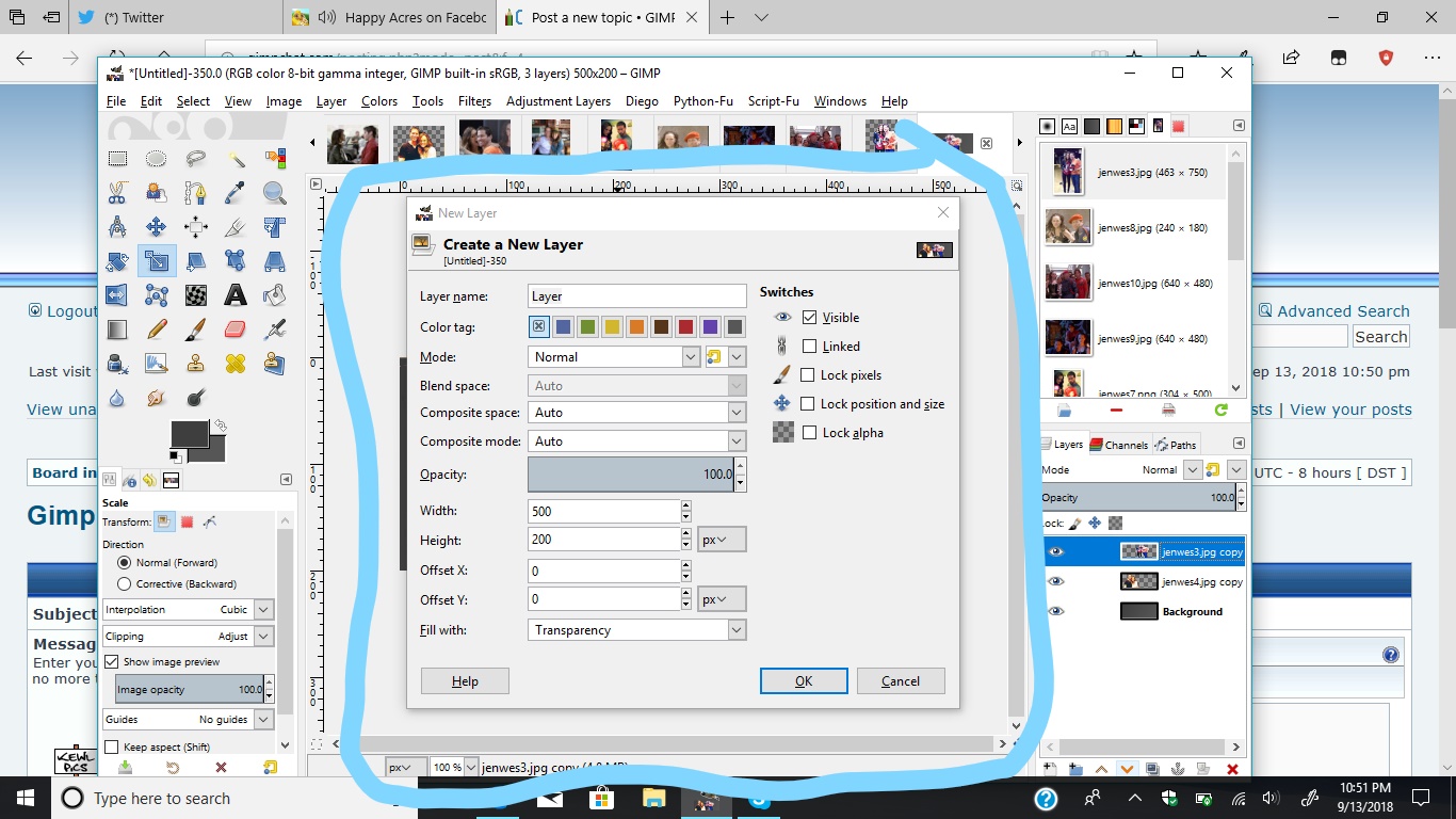

When we create a new layer in gimp, what do the new additions do & how are they used?

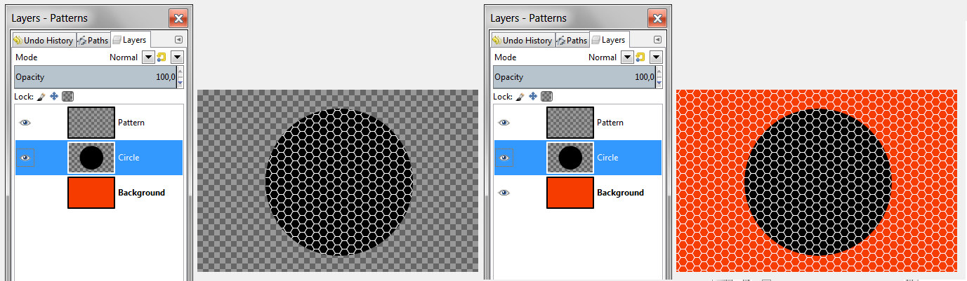

Im confused by the 'Composite Mode'.
Is this something like a clipping mask ?
For example you can create a circle on a transparent background, put another transparent layer on top and fill it with a colour or a pattern.
(instead of setting the composite mode in the layers dialogue, you can also change the mode in the rightclick menu)
Lets say i set the 'Composite Mode' to 'Clip To Backdrop'. Although i filled the whole layer with a pattern, its clipped to the circle.
But this only works as long as the image has transparency. As soon as i add an opaque background the pattern filled layer is completely visible.
So im not entirely sure how to use this feature.... Any ideas ?

mackenzieh wrote:
I read it but it wasn't giving a good explaination to the new layer additions.
There isnt really much that is new. It seems they tried to cram as many options as possibe into the new layer dialogue.
Perhaps this is useful if you need to create a lot of new layers with very similar options.
Color Tags are new and good for organising your layers.
Offset is a new option, that was formerly an extra step through 'Layers -> Transform -> Offset'.
Lock Pixels is nice to lock a layer to prevent unwanted alteration.
The problem i see with some of these new options is that the layer doesnt give away what was done to it. This might lead to a lot of confusion when your layer misbehaves because you accidentally activated a new option.
