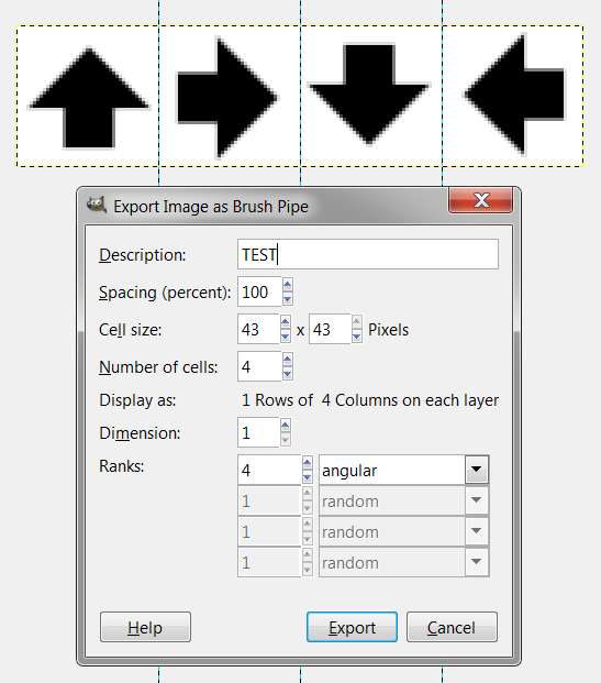

Here is a teststrip i made
When i set Ranks to one, it doesnt follow direction, but when i set it to four it does.
Same result when i have layers instead of a single strip.
For some reason Ranks is limited to 100, so i guess its a bug.

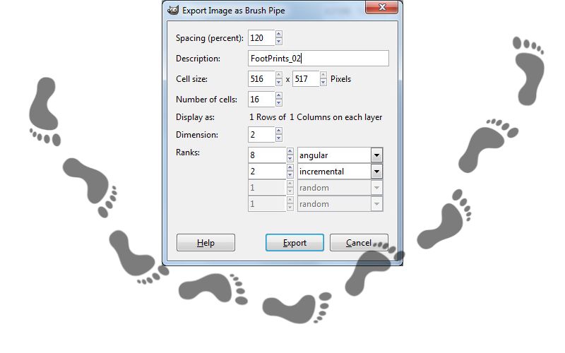

I made this brush a long time ago (2.8) by following tutorials here:
https://www.gimp.org/tutorials/list-all.html
(Image Pipes, Image Pipes 2)
It shows a use of Ranks.
FootPrints_01_small.zip [74.19 KiB]
Downloaded 252 times
