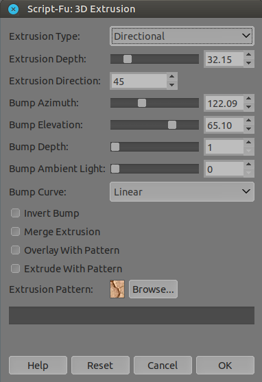

Filters > Render > 3D extrusion... (my settings which are different from @teapot)

The extrusion settings were all default except:
Extrusion depth: 15
Extrusion direction: 45

The extrusion is neat and I'm almost sure the water effect was 100% generated in GIMP without plugin.
If I think @teapot did the extrusion via the 3d-extrusion.scm plugin, I will not use it for this exercise.
Instead today, I'll show one method on how to do it without plugin, it's not the fastest method, but it's a very simple one and it has a lot of precision and more important > the result is very neat.
