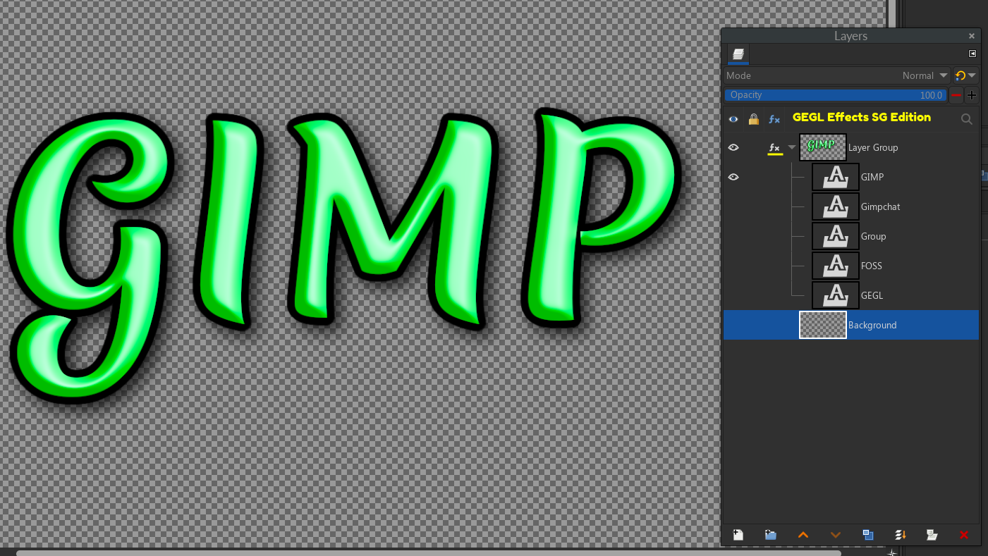

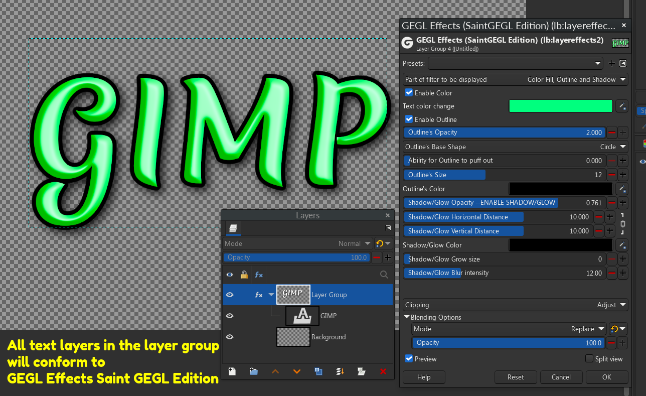

An alternative version of GEGL Effects for adjustment layer groups
I'm sure everyone who reads my post knows the GIMP 3 bunker repo is deprecated and has been removed from my Github. However the GIMP 3 bunker repo had an alternative version of GEGL Effects `sg:gegleffects` that version of GEGL Effects has the following listed features
1. works on adjustment layer groups
2. does not use zzstrokebevelimage
3. uses plugin ops of mine like custom bevel, ssg that normal gegl effects does not use.
4. Has a color on off disable checkbox
I am porting that build of GEGL Effects to my main Github as an alternative branch.
Put simply, GEGL Effects is getting another alternative version that can co-exist with the default. The alternative version works on layer groups. That is a huge deal in 2.99.19 because all text layers in the layer group will obey it.
 Post subject: Re: Plugins that once failed adjustment layer groups will be fixed
PostPosted: Sat Sep 07, 2024 9:51 pm  (#13)
Joined: Oct 31, 2020
Posts: 2025
I could be wrong but it seems impossible to make GEGL Effects continual and experimental to work on adjustment layer groups. The only answer was an alternative edition. Attached is the source code of GEGL Effects Saint GEGL Edition that works in both 2.10 and GIMP 3
2.10 users will appreciate everything but the adjustment layer group abilities. All users (2.10 and 3) will notice the outline bevel is different because it uses lb:custom-bevel instead of lb:bevel.
Source Code of GEGL Effects (Saint GEGL Edition)
gegl_effects_saint_gegl_edition.zip [112.54 KiB]
Downloaded 267 times

All the layers in the group will conform to GEGL Effects SGE
Every text layer in the group is effected by the same style
