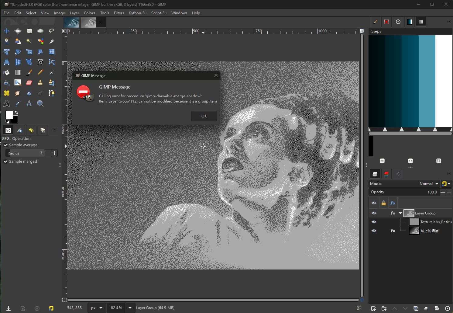

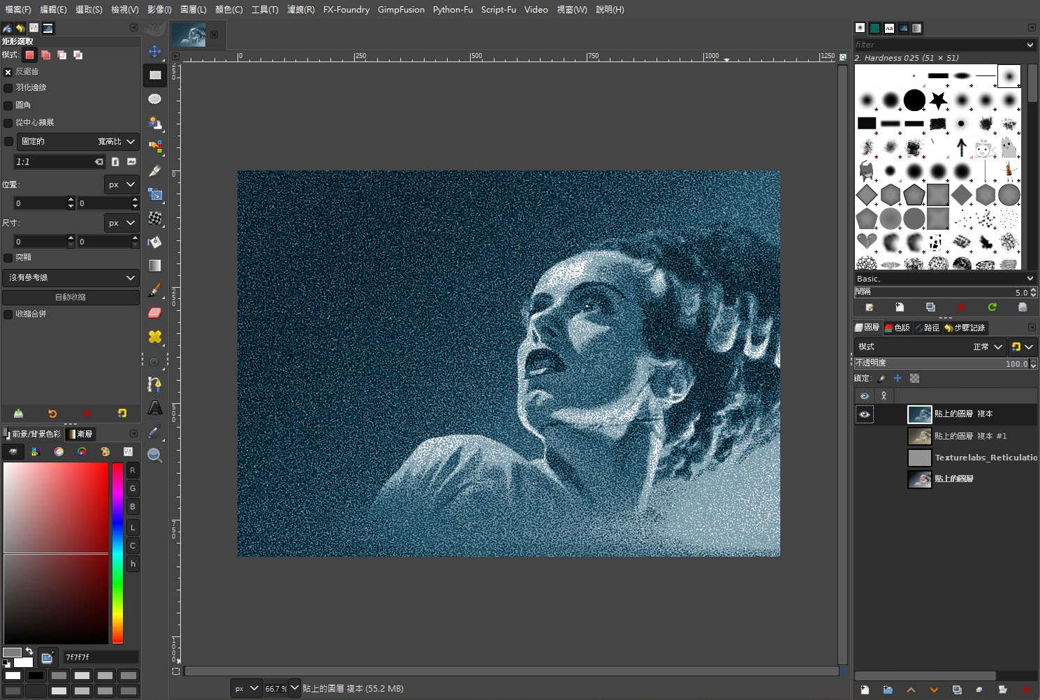

In this Photoshop tutorial
Photoshop Game-Changer! GRAIN SHADED GRADIENT MAPS
This was done with GIMP 2.10.38
It needs to merge the layers before applying the filter
But its final effect depends on some adjustments, so it may require frequent use UnDo.
So I tried using GIMP 3.0 instead.
But in the last step Gradient Map, I got this
It's so frustrating

At the moment, NDE only supports GEGL filters. Gradient Map is a "legacy" plugin. You can see it better in Gimp 2.10 where the GEGL filters have a G against the menu entry. The G has been dropped in GIMP 3.0
Edit: Sorry I do not watch YT videos anymore, too many advertisements.
You will just have to find other ways: Here two NDE filters that are still editable + a gradient but that relies on a Layer Mode.

There has been a discussion about the "Merge" choice of filters, and it has been pointed out that some filters, having no dialog, don't give the choice.

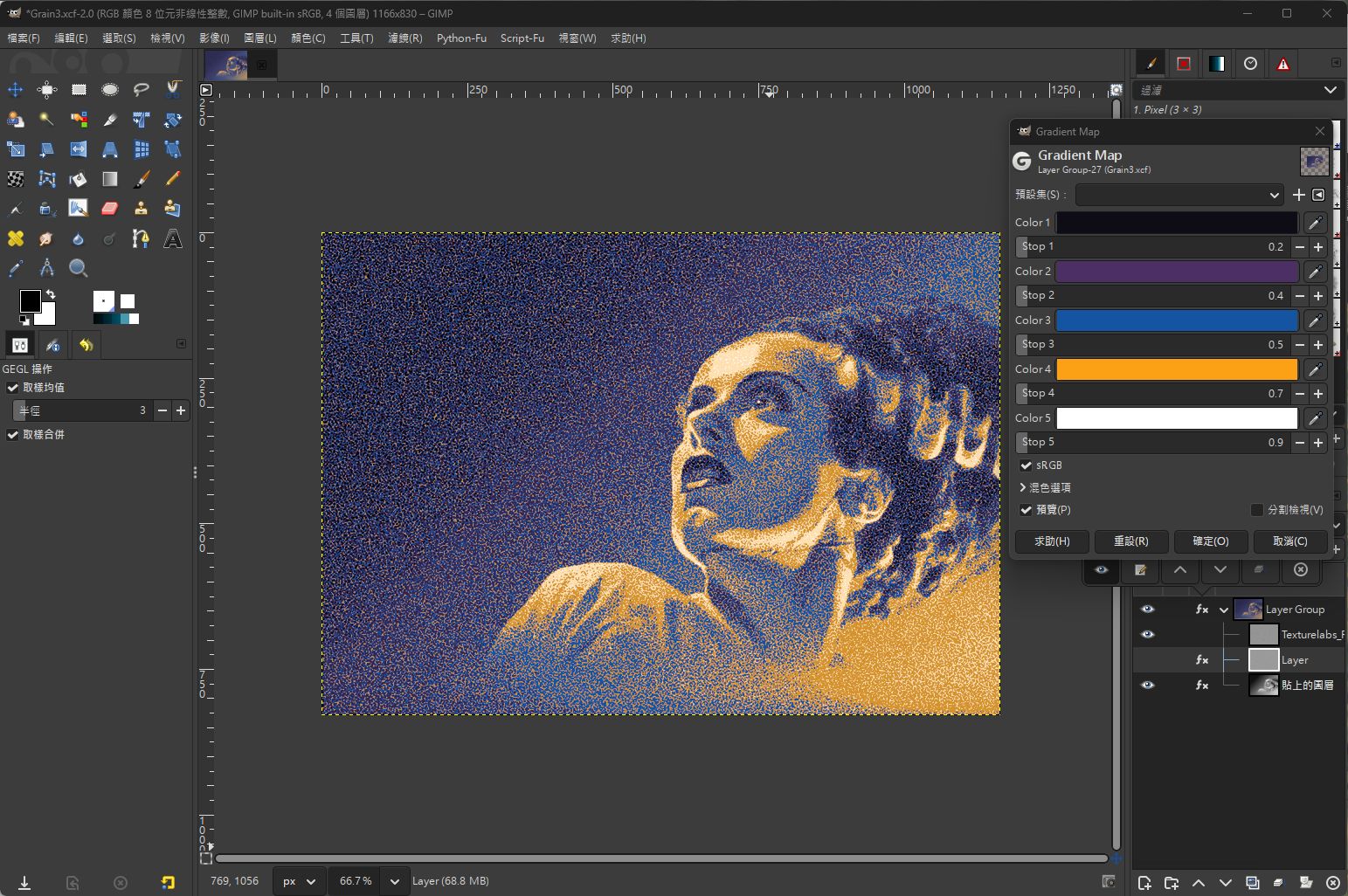

gegl-workshop.dll was provided by GIMP 3.0 RC1, but has been removed since RC2
You can copy this file from RC1 yourself, or if you feel more confident you can download the file I attached.
Put the file into the xxxxxxxx\GIMP 3\lib\gegl-0.4 folder

JamesH, I already solved that problem and don't recommend your method.
You can download gradient map and all other hidden native GEGL filters here as plugins.
https://github.com/LinuxBeaver/GEGL-GIM ... s/releases
Its a lot safer then that .dll modification trick. Because they are installing as a GEGL plugin

from what I've noticed in this plugin I can add up to 5 colors to it right ? so it can generate a gradient map of up to a 5-colored-gradient no more. right ?

Yes, here is a example
Hello everyone!
Gradient Map from this link that previously worked for me with GIMP 3.0 doesn't appear in GIMP 3.2 !
is there an updated version that works in windows with GIMP 3.2.6 ?
