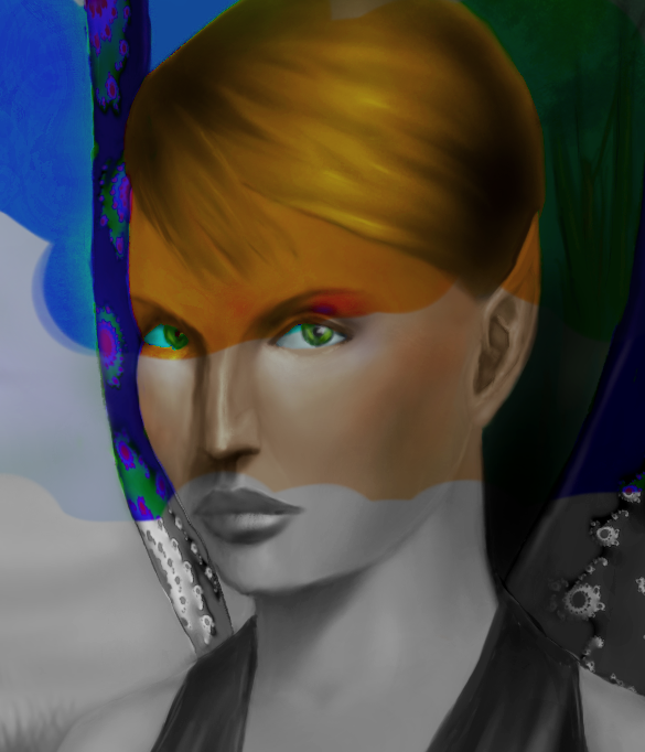

It seems I can't get to preserve the brightness.
I don't get the differences between real and apparent brightness, but lets put it aside until we figure out how to solve the apparent brightness distortion caused by saturation.
Here's what I get using Erisian avatar (hope you don't mind):
originals are on the first row.
What I see is that my saturation layer darkened the image, I then ran desaturate-brightness to verify.
 Post subject: Re: Looking for a saturation tool
PostPosted: Sun Jul 08, 2012 2:30 pm  (#9)
I don't mind at all. :) Try this in order to understand. Open your foreground colour to reveal the colour selection dialogue. Vertical movement gives saturation and horizontal gives brightness in computer terms. As a colour becomes more saturated, it becomes more intense giving the illusion of being darker. The brightness hasn't changed in computer terms but visually it appears darker the more saturated it is. I'm afraid this is an unavoidable bi-product of saturating. What you might want to do is put a duplicate of the original on a value layer on top and run levels or brightness/contrast on it. Hope this helps.
