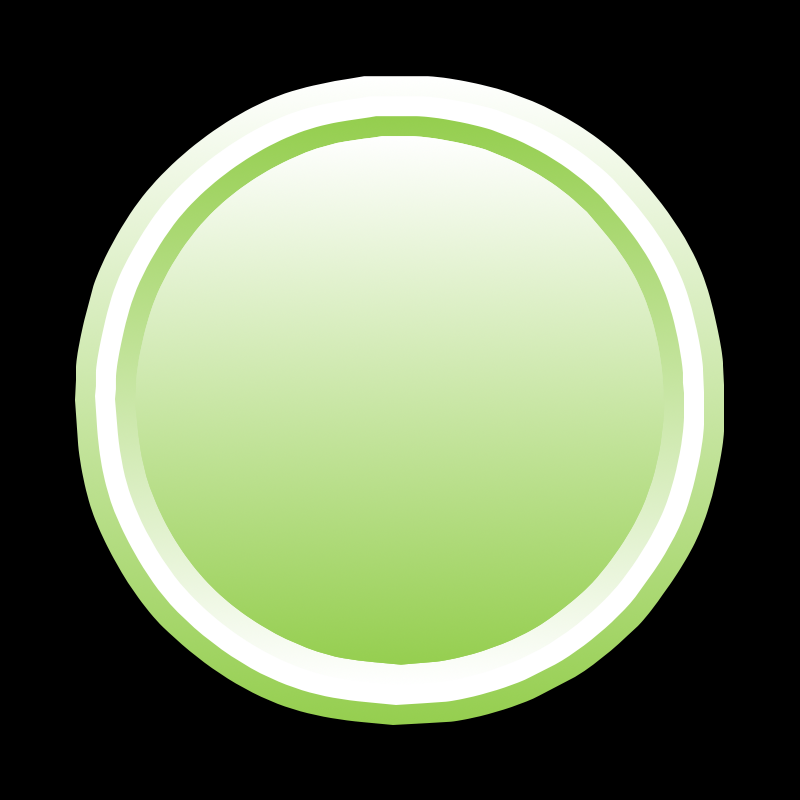

Yesterday i tried to replicate this label from a record, which consists of several rings, filled with a gradient.
And when finished it looked like this, which is pretty horrible, i think (the colors dont matter, please ignore that detail).
Its not exactly a perfect circle, really, isnt it ? *lol*
So any comments ?
Is this a problem with GIMP ?
I guess a solution would be to make every ring a circle on its own. But that would need a different procedure:
i would have to plan my piece, so i would know before, what size each circle is going to be and convert the selection into a path, which is different to working with one circle and shrinking the selection.
But i have the vague feeling, this is a basic problem in GIMP with anti-aliasing and maybe this kind of stuff needs to be done with Inkscape, because scaling works better with vectors ??

There is a discussion in this thread about the difference between stroking a selection and stroking a path. You are correct about the advantage of stroking a path, however, there are distortions to your circular selection that were introduced when you grew your selection. These distortions were then incorporated into the path when you did "Select->To Path".
The distortion such as exhibited in your examples is created whenever you grow a selection. This is somewhat related to the discussion in the aforementioned thread because growing a selection works by painting with a round brush around the outline (marching ants) of the selection. This can be seen by growing a rectangular selection and noting that the corners of the resulting selection are rounded. When an elliptical selection is grown, the top, bottom, and sides become "flattened" (as seen in your images).
A good way to correct for this is to, in the case of growing an elliptical selection, clicking within the grown selection with the Elliptical Select Tool. This will cause the resizing handles to appear. Move the mouse to the top resizing bar and then press the cursor left key on your keyboard*. This will result in a "new" elliptical selection that is the same size as the original, but with the distortions caused by growing eliminated. Click in the center of the selection (or press ENTER) to accept this corrected selection. (A similar operation can be used for rectangular selections, only with the Rectangle Select Tool.)
* Alternately, you can place the mouse pointer over either of the side resizing bars and use the up or down cursor key -- the idea is to not actually resize the selection, but to "trick" GIMP into thinking you have.

If you want really circular paths, don't obtain them from circular selections. Use the excellent shape-paths script to produce circular paths (it will also produce other geometric shapes).
