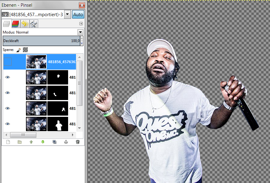

so i rendered the picture in four parts
part one: body with a standard layermask (you know, b/w copy, values)
part two and three: selected the arms with the path tool and used a selection layermask
part four: bits of the dreadlocks and beard (painted the layermask by hand)

Nice technique, Esper!
For the same task in my recent post here I used Foreground select tool and then Fuzzy select tool to remove what is left from background (I usually set threshold to 20-25 and press Shift key to add to selection). In the end I always alpha select, shrink by 1 pixel and invert-clear to make the edges clean. Fast method for less accuracy and takes about 4-5 minutes.
 Post subject: Re: whats the best and fastest way to render this picture ?
PostPosted: Thu Dec 06, 2012 10:47 am  (#7)
interesting K1te !
i tried it but used the foreground selection tool to turn the selection into a layermask, because i felt that would give me more control
it was indeed pretty quick, but there was a look of cleaning up to do, with the fuzzy select tool
getting the edges clean is always the biggest problem, so your technique with shrinking by 1px is a good choice i think
