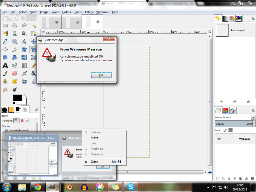

Joined: Dec 01, 2012
Posts: 29
tried to open a few websites, all came back with a white screen, then i got this error message
my website thingy
 Post subject: Re: Create from webpage issue
PostPosted: Thu Dec 06, 2012 5:42 pm  (#17)
If it is a Windows only problem then i may guess the culprit
The same that prevent to open the Gimp help (with the default option) in Win:
Only from the windows build somebody decided to remove the Gimp browser plugin that allows to open html pages
So as the gimp help in windows cannot be opened (if not using a external browser ) the "create from webpage" may only fail because in the win version of gimp there is no more something that may open web pages...it was but was removed
So only fix would be reinstall the gimp browser
(that anyway was removed because in Win was quite buggy ).

looking better the WebKitGtk page i believe i was right :
It is required by the Gimp browser to work, but without the gimp browser the poor webkitgtk has nothing to do in gimp :
except wait for calls that will never come
