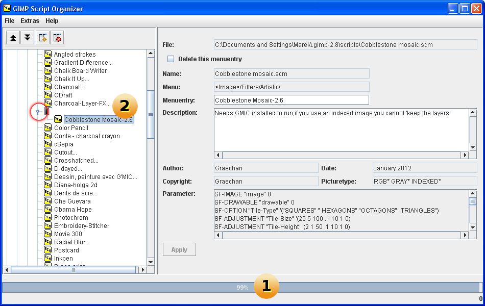

Revelation!
Two questions:
1. File - Load Directory-only 99% (the rest are errors ?)
2. What does this mean (script error...)
 Post subject: Re: JGimpOS - managing scripts
PostPosted: Sat Dec 22, 2012 12:08 am  (#7)
I noticed the 99% load as well, I can't replicate. My log also showed lot's of unknown errors.
If you want to know where the log file is look for "jgimpos.log" in the users folder.
For example in Win,
C:\Users\Odin\.jgimpos\jgimpos.log
Ed.,
The error might be gimpfx-foundry scripts.

I have uploaded a newer version (first post)
@MareroQ:
1. I don't know. try the newer version. The log should say which script could not be loaded. The progress should go up to 100% (in the newer version file-number/total-files) This is reset, if clicked anywhere in the window.
2. It's not a bug, it's a feature :-) The menu of the script ends with "/". Thats not usual, so the program "thinks", there must follow an other menu entry, so it creates a new menu entry in the tree structure, but with no name... I fixed it, so "empty" menus are not longer created.
I fixed up the log. It was written, whenever a script was loaded/saved but when tehre was no error, it says only the event time, the severity level (ERROR) and then the errors. Mostly nothing. Thats confusing.
Now, if there is no error, the log is not written.
@Graechan:
Sorry, I can't help you. The program can be anywhere, just double click on it.
Maybe you can try start terminal/cmd window, change directory to where jgimpos-2.0.1.jar is, type:
javaw -jar jgimpos-2.0.1.jar
watch the error.
