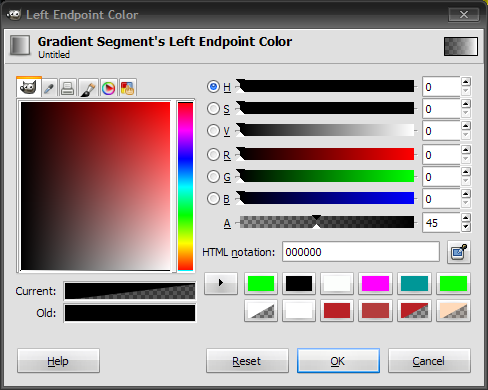

A different implementation can be found in the Gradient Editor, which has a slider for the opacity.
Nice catch.
