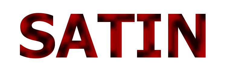

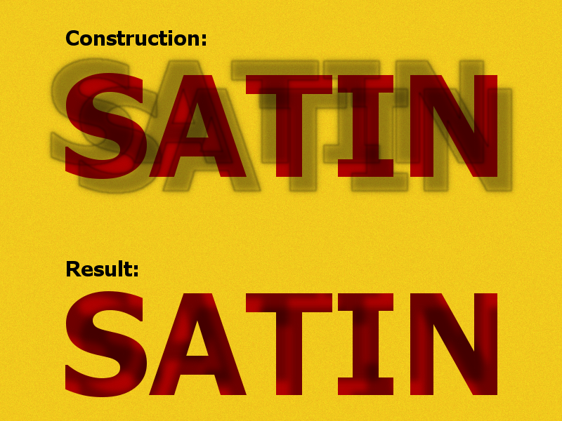

the last effect i didnt explain yet in my "make layerfx effects by hand" tutorial, was the 'Satin effect'
technically you achieve it by two duplicated blurred layers and offset them in opposite directions
in PS the intersection of the two offset layers cancel each other out, so that you mostly end up with a shadow kind of effect
you can see the construction and endresult here:
i used: Tahoma Bold 200px, Offset 20/20; -20/-20, on Multiply 60%, Gaussian Blur: 15

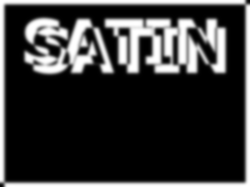

when you use the FX-Foundry Satin script, you get this layer with a layermask on top:
now i need your help because i just cant replicate the effect like this
i tried using three saved channels, two of them offset, but i dont know how to combine the selections to get the same endresult
here is part of the code for the FX-Foundry Satin script, maybe somebody can translate that for me into a mini-tutorial ?!
If I understood you correctly, it's a layer mask you're after.
FX Foundry is written in Scheme scripting language, and to see how and what it does, you can simply enter one by one the lines of the code inside Script-fu console in Filters>Script-Fu .

PostPosted: Thu Feb 14, 2013 8:47 am  (#17)
Posts: 12870
World's smallest pattern and it's significant role in satin.
zipped the pattern and xcf file; the xcf file pretty much is the tut. Used the base image as the displacement for the pattern fill. Shown below are the 1x1 displacement and the 5x5 displacement examples (xcf is the 1x1 displacement). It's all about the moiré. Play with various opacities, colors, and displacement ratios until you get bored. :)
satin.7z [527.1 KiB]
Downloaded 115 times
