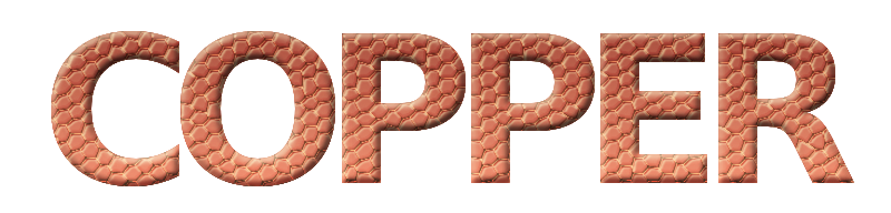

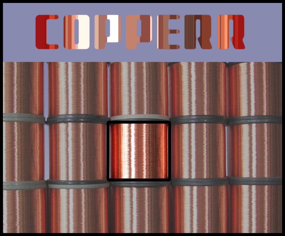

is there a filter that lets me get that ripple effect you can see on the wires ?
i made this text from different bands of colour and now i want to distort it so that i looks like the wirespools
but 'Wind' only works on edges and all the other filters, including G'MIC dont seem do to the job either
got this result with a combination of Spread Noise and Ripple

Here are two links to spools of copper wire, Esper. Do they have the effect you are looking for?
http://images.wisegeek.com/copper-wire.jpg
http://ttc2010.files.wordpress.com/2010/06/8249831.jpg

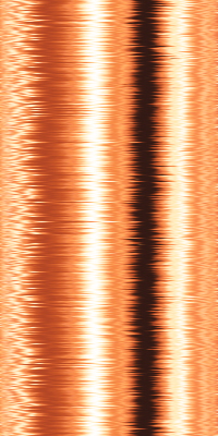

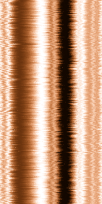

Is this something what you're after, Esper?
Image Image
Edit. I don't have copper gradient, so I applied a distortion on BW Crown Moulder gradient and colored it to look like copper.
Displacing gradient by 20 or so along X axis.
To make a displacement map - add correlated RGB noise at 60% to the white bg and wind-distort at about 30 for Strength. I used 'Both' for Edge
in this example but don't think it really matters.
[ Image ] [ Image ]
This is excellent! :bigthup

K1te, you are a hero !!!! :clap
your result is pretty much was i was after, even the colours !
thank you !!
@Oregonian: thanks for your help, i wasnt really asking for copperspools, but after i read your comment in Rod's Steampunk-Copper-Effect, i had to give copper a go ;)
btw, this is what i got in the first round
its far from good and looks more like a cookie :mrgreen:

he4rty wrote:
Did have a quick play and I think the problem I'm seeing is the fact the text is flat but the spools are curved and the light/shadows created by the curve is hard to translate to the text.
i agree and it will not work with my coloured try either, despite the fact that K1te came up with a great idea for the look i was asking for
but this will be useful for other metal-texture-effect

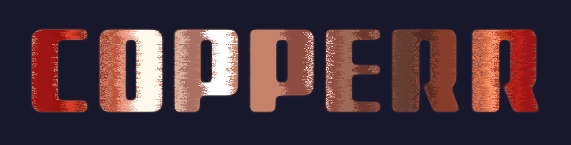

and this is what im really after

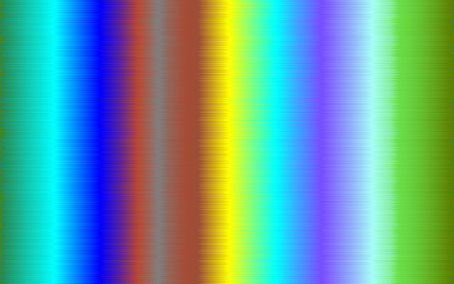

here is Kite's spool with the copper gradient supplied in Rod's Steampunk post.
I applied the map to gradient , a small curve correction to go more reddish and a gaussian blur Horizontal 4 vertical 0. Image

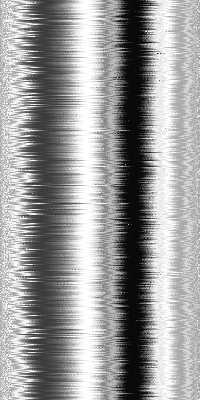

I actually grabbed your image and used Change Image on it to obtain the gradient.
Results
And with a little brightness and contrast manipulation.

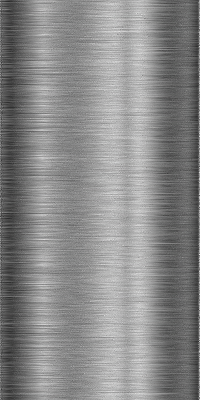

lots of good things coming out of this thread ! :clap
i tried to apply the new techniques
Nice effect, Esper! Looks like brushed metal.
I'm gonna play around with this technique and see if i can make
various hq brushed metal textures for my 3D projects.
Edit. Just dawned on me - I can use these textures to imitate anisotropic
light scattering on distant objects where i don't need great amount of detail
instead of using expensive anisotropic shader in Blender! Cool!
@Rod Cool idea to use pixel spread!
Esper that looks terrific! It has a real metallic look to it :bigthup
Note: After using Noise>Spread i had to trim the edges a wee bit as they were roughed up.As you can see in the spread interface preview. :)
