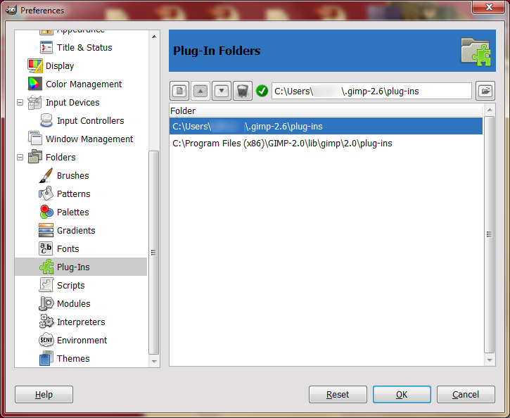

Folder desigination for your user looks wrong. it should be c:\Documents and Settings\Owner\.gimp-2.6\plug-ins and not with the _gmic subdirectory (using your paths). GIMP will find all the plugins in subdirectories. Your gmic plugin should be in plugins directory and there is an additional subdirectory _gmic as you have in your plugins directory. I think that is your problem. Edit the path as I mentioned, close GIMP and re-open it again and I bet it will work. Below are the files that should be in your user plugins directory. :)

Not understanding what you mean? could you explain in a easy English...LOL and how I can edit it and do I edit at the doc and settings file or the file /preferences?

Exactly change that user doc path to NOT include the g_mic folder...thats your problem.
It cant find G'MIC.exe

OK Micki; just go to your plugin paths preset and click on your user path (I use Win7, so mine's different then yours). Then end of the path though is identical (\plug-ins part). See the screenshot below. :)
