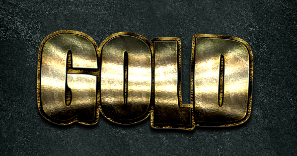

Posts: 14268
You might be able to apply 'Lens Distortion' to a gradient. I tried that out and got something close. I use a metallic gradient and duplicated it, flipped it vertically and erased what I didn't want in one of the gradient layers. I also had to scale the gradient a little once it was stroked, to fit the text.
Sorry but I didn't save my results, but it was very close. I also added some HSV noise to the gradient after I did the curve.
I did it again to show you what it looks like.
These were done without flipping or duplicating the gradient and removing unwanted stuff.
Here's another that I did using a step gradient.
You might have to create you own gradient to make it more exact.

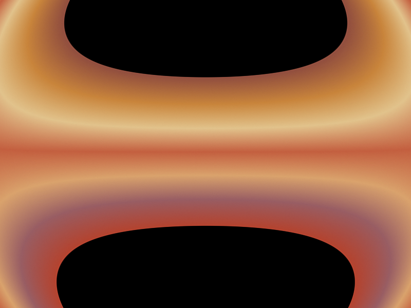

he4rty: i tried the curve bend previously as well and didnt like the results very much, thanks for the suggestion ! :bigthup
Wallace: this is very very close to what im looking for, but i have problems replicating the effect
we are talking about 'Filters -> Distorts -> Lens Distortion' here, right ?
if i set Main and Edge to the minimum (-100) and Zoom to about 20 i get something like this, which is kind of close to what you did, but not really the same
can you please repeat your effect, and tell me the values you used ?!

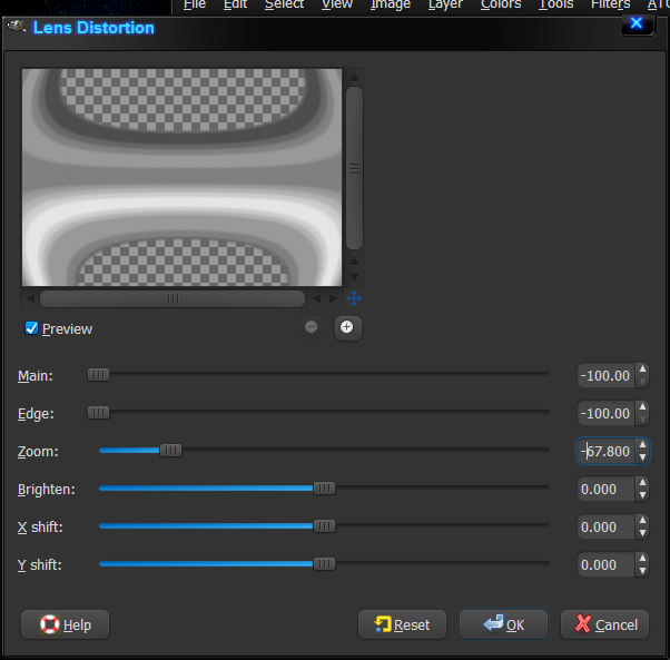

if i set Main and Edge to the minimum (-100) and Zoom to about 20 i get something like this, which is kind of close to what you did, but not really the same, can you please repeat your effect, and tell me the values you used ?!
Your Main and Edge settings are good, except for 'Zoom'. I'll take a screenshot, to try show you what I did. The gradient used is also important. ;)
This is the image I came up with...
Here are the Lens Distortion filter settings I used...
I also applied the 'Posterize' filter to the gradient, to break it up into more lines of color, (although you may find this isn't needed. 'Posterize' can also be applied before or after the Lens Distortion filter). Apply a mild 'Gaussian Blur' to the resulting gradient.
I've included the xcf file that will show how I create the effect.
Scaling the gradient to then fit the text, is another thing I did that can be seen in the xcf file. Scaling the gradient down to fit the text, can help to form the shape needed for this effect.
I hope this helps.

Without any fancy tricks or borders, just the curved gradient. Made the gradient as a layer, then took the curve bend tool to it. Squeezed the middle and this is what I got.
