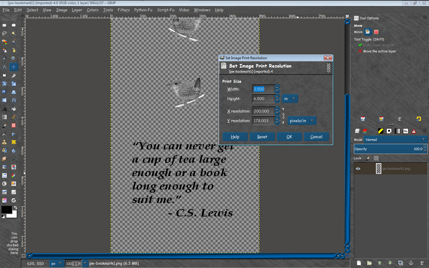

When i go to Image>Print Size in Gimp i get these dimensions which seem correct.

Thanks Rod - so I take it this means that somehow the pHYs is incorrect but not sure how that would happen or why...and how to change it is a complete mystery :roll:
...and I get the same details in Gimp that you do.
