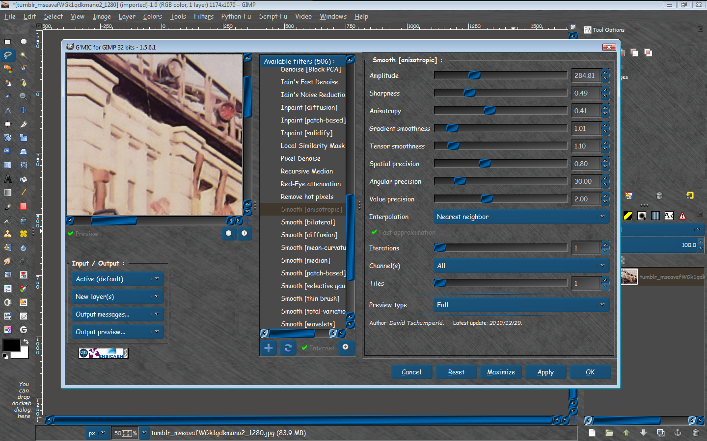

I got some pretty good results by just using Repair>Smoothing - anisotropic with these settings.
