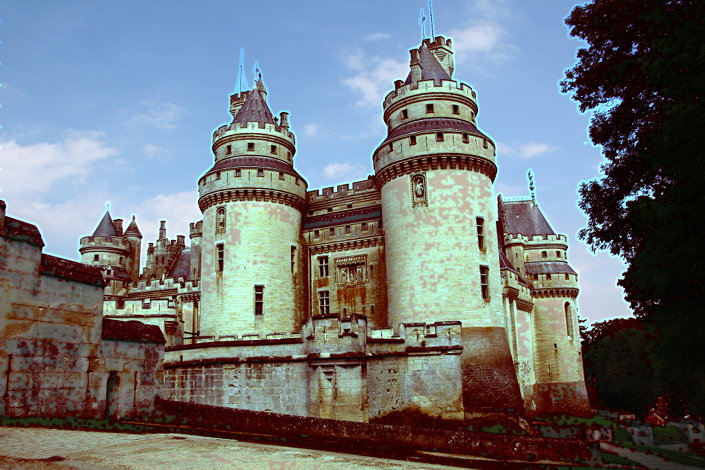

Poor man's method:
Let' say you have a photo of the most magnificent medieval castle in known space, so magnificent that even though it's in France, the Rosbifs from across the Channel have elected it as the set of one of their medieval TV series, and the logo of a well-known American entertainment company has been inspired by it. Unfortunately this photo lacks contrast on the castle:

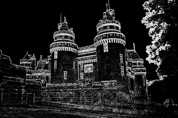

Duplicate image layer, gaussian 2px and set to difference mode. New layer from visible, apply threshold (fairly low value). In my experiment there is a range of threshold values where you don't get any spots in the sky while the rest of the image starts to fill up.

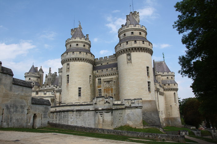

To finish, open the Channels view, right-click on a color channel, and Channel to selection. Apply completely overdone contrast:

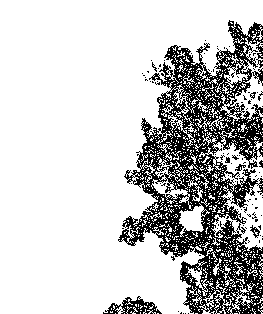

Best that I could do using highpass, bilateral, auto-level and dilate Rob. A lot of work and still not complete. :)
ref:
result of said operation:

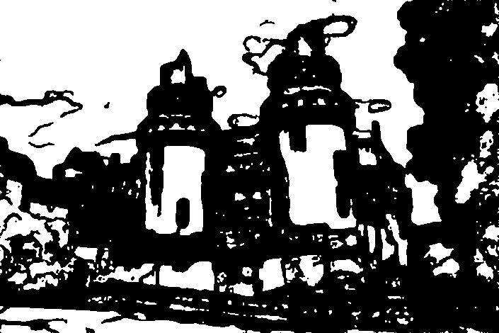

Hi, I dont know exactly what the result should look like but I prepared two images, if any of them is nearing what you want, I can write more about it

Well, you must know, but by my understanding this should work as desired, here is an example, my image was used as a mask over layer modified with standard unsharp mask

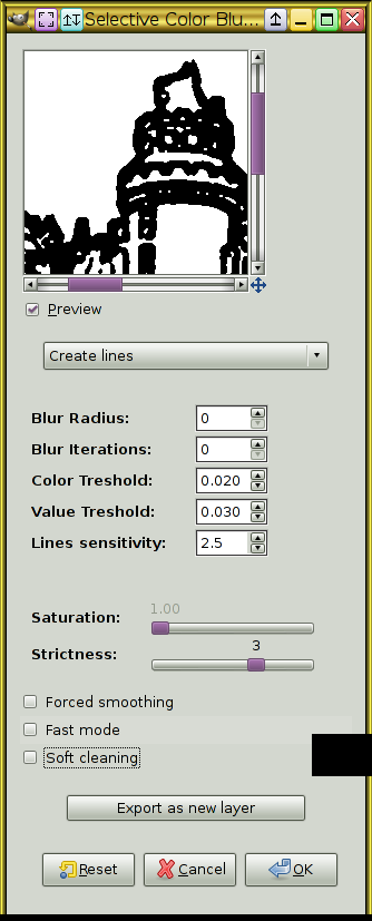

Posts: 27
I have no code for it.
I am (mis-)using selective color blur plugin, see screenshot
the procedure is
1. blur softly original image
2. use the colorblur plugin
3. and the output is a mask (must be blurred to make the masking effect gradual)
