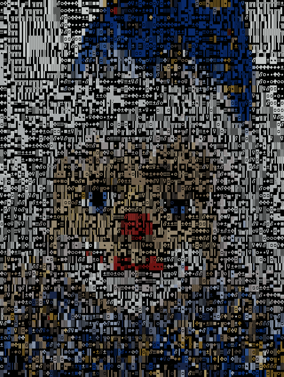

Bonjour,
Here is an example (Made from script-fu "ASCII UTF-8") of what I want.
Any suggestion faster than my new script running Gimp would be appreciated.
 Post subject: Re: ascii
PostPosted: Sun Dec 22, 2013 3:35 pm  (#14)
Joined: Apr 23, 2010
Posts: 1553
One way to speed up your script is to disable UNDO for the new image -- you are currently using 'gimp-undo-push-group-*'. The only thing that performing undo would accomplish on a new image is take you back to an empty image. This is not worthwhile (you'll notice that all of the images created under "File->Create" menu have empty undo histories).
When you use gimp-undo-push, every operation you perform that modifies the image requires an additional step to save that operation in the UNDO history. By disabling UNDO, these additional steps are avoided. How much speed is gained by this depends upon what your script is doing.
I have been looking at your script and think you might also benefit by using lists and vectors to hold all of your car_### variables. Script-fu does not using any fancy symbol lookups for local variables (the theory being that you will typically only have a few) and so when you have hundreds of local variables (such as car_0 through car_188), it might have to traverse the entire list of variable assignments every time it needs to find or change a variable's value. (Script-fu does optimize lookups for global variables, since there can be expected to be thousands of those.)
By using lists for your car_### strings, you can use 'map' and 'apply' which will simplify some of your code (though maybe not improve its speed much). You can then convert the lists to vectors and use 'vector-ref' which I suspect would be faster than your current approach which requires linear searches of local variable bindings.
Here is some of the re-working of your code that I have done. It should give you an idea of what I mean (of course, the 'define' statements would be replaced with 'let' statements). I haven't reached the part of your code that actually places the characters, but it looks as though converting 'car_set' and the 'hauteur' and 'largeur' lists from lists to vectors would address what you are doing. If you decide to take this approach, be aware that I have used a string comprising the space character (" ") instead of the empty string ("") in 'car_set'; though I treat the space as an empty string when computing its width and height.
I normally wouldn't post such incomplete code but I probably won't be able to do anything further with it until after the holiday.
PostPosted: Sun Dec 22, 2013 5:01 pm  (#15)
Joined: May 09, 2012
Posts: 914
Bonjour,
@Saulgoode
Thank you for the reply and suggestions :tyspin :)
UNDO
In my new script I deleted it and added this line (gimp-image-undo-disable xxxxx) . This greatly improves things :)
lists to vectors
I will follow this advice and create things that look like this for UTF-8 :
(xxxxxx #(
(list #xE8, #xEF, #xEE , #xEC, #xC4, #xC5, #xC9, #xE6, #xC6, #x25B6 )
(list #xF6, #xF2, #xFB, #xF9, #xFF, #xD6, #xDC, #xA2, #xA3, #xA5 )
(list #xC2, #xAE, #xE1, #xED, #xF3, #xFA, #xF1, #xD1, #xAA, #xBA)
I'll see if it is faster, the work is not huge (I write a lot of scripts with OO.o spreadsheets and functions "text").
I'll make databases with 256 characters to avoid intermediate conversions (1 color = 1 character)
Again thank you for the advice , I will make a new version of the script viewtopic.php?f=9&t=9341

Bonjour,
:tyspin Rod , :tyspin Saulgoode
Here is a new version of the script-fu that uses lists of characters (256 characters per list).
The script is in the archive message : viewtopic.php?f=9&t=9341&p=121326#p121326
It is always very slow (iterations are causing the problem).
Renderings are different from version 1.
Access to an RGB image by : Filters > Render > QWERTY 256 ...
Each character is positioned in size to the center of the rectangle color.
Merry Christmas
Edit 20131224 : New Version
