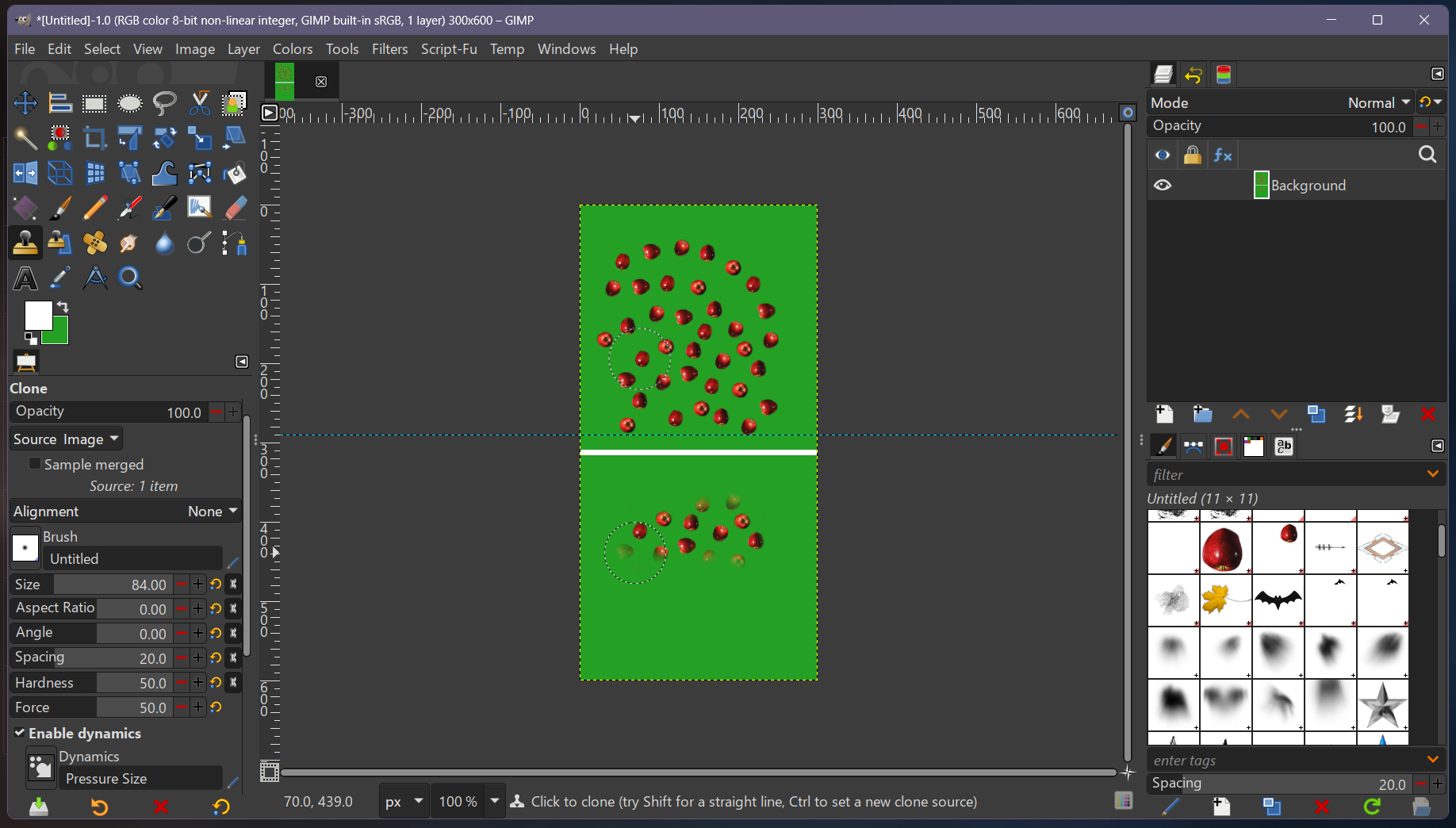

Check that tool size is appropriate,
also use CTRL to select the source.
Move the crosshair of the tool to the location to use as the source,
Ctrl + Click to select the source and begin cloning.
Seems to work OK for me using GIMP 3 on Windows.
I cloned some of the apples from the top to the bottom.
