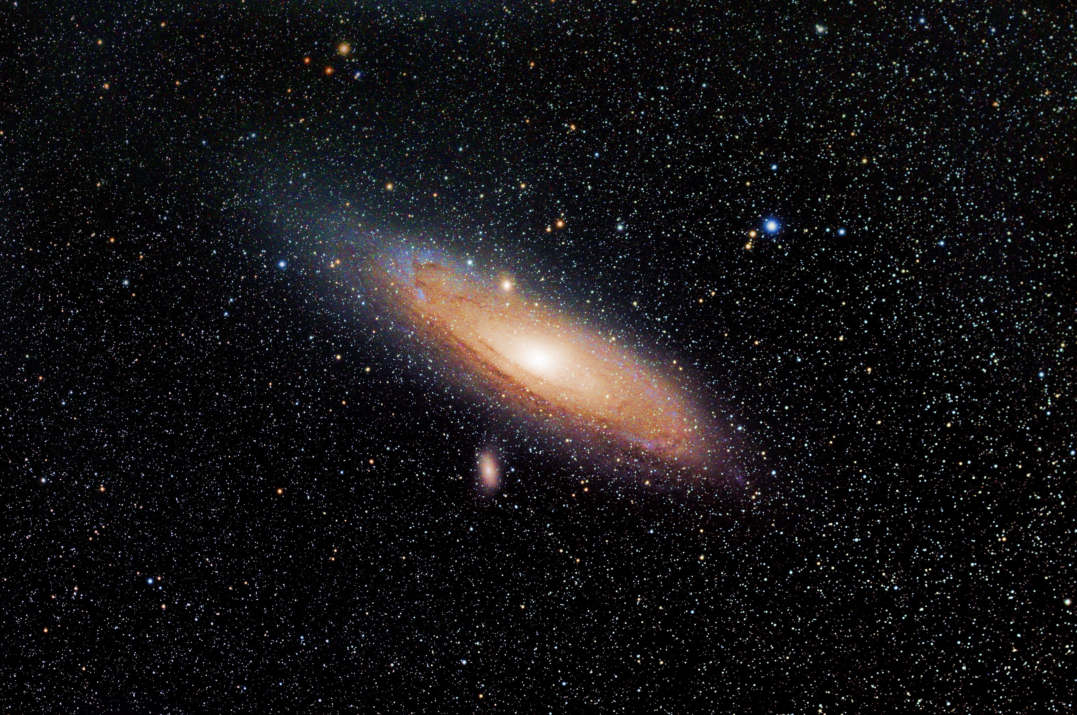

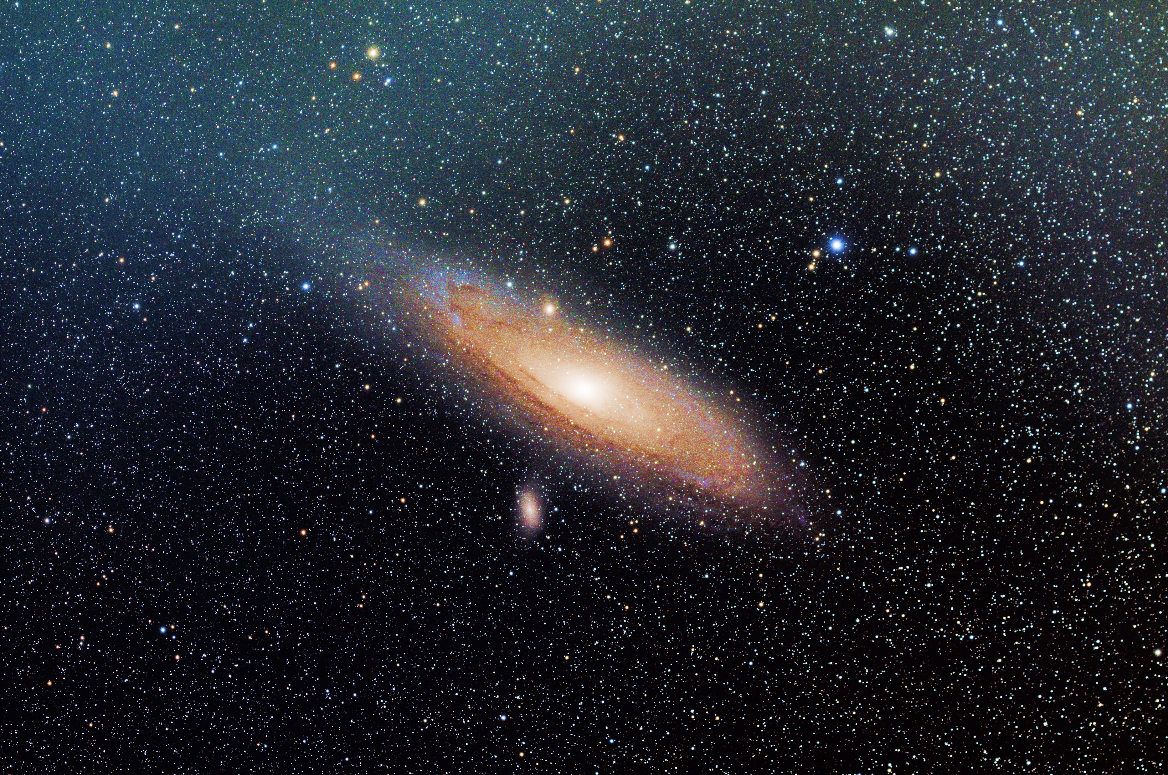

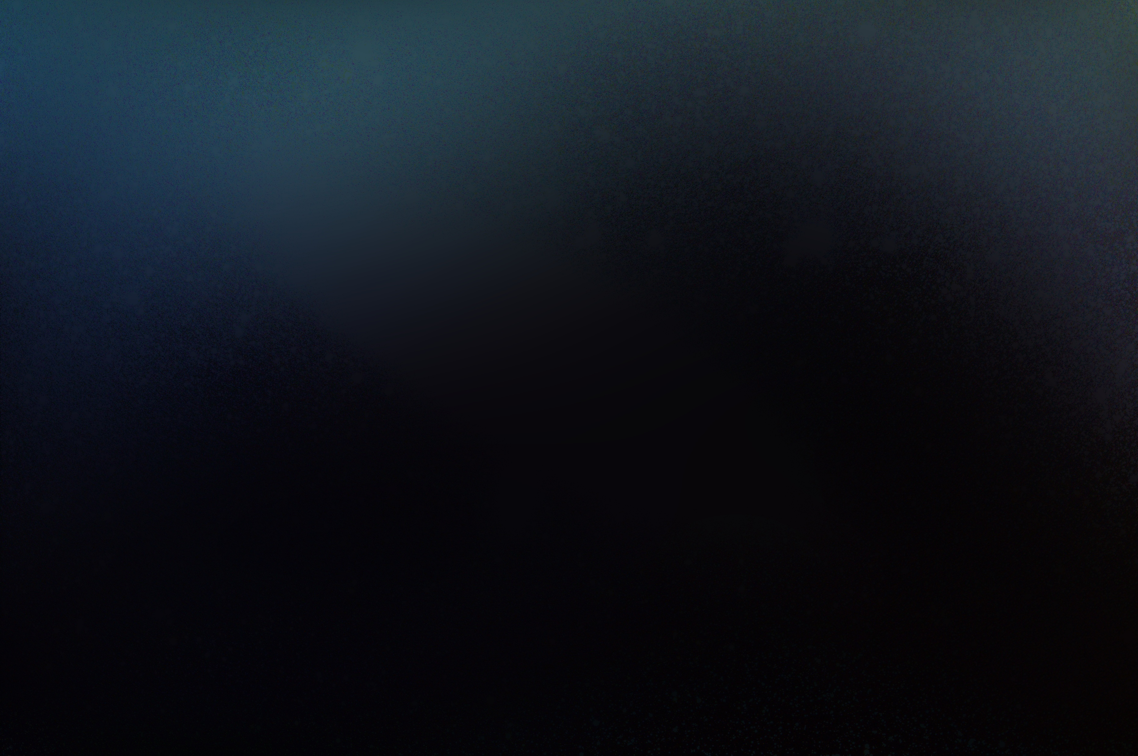

I just finished a Scilab script that does the job very well. Let me show what it does in steps. Here's the original image:

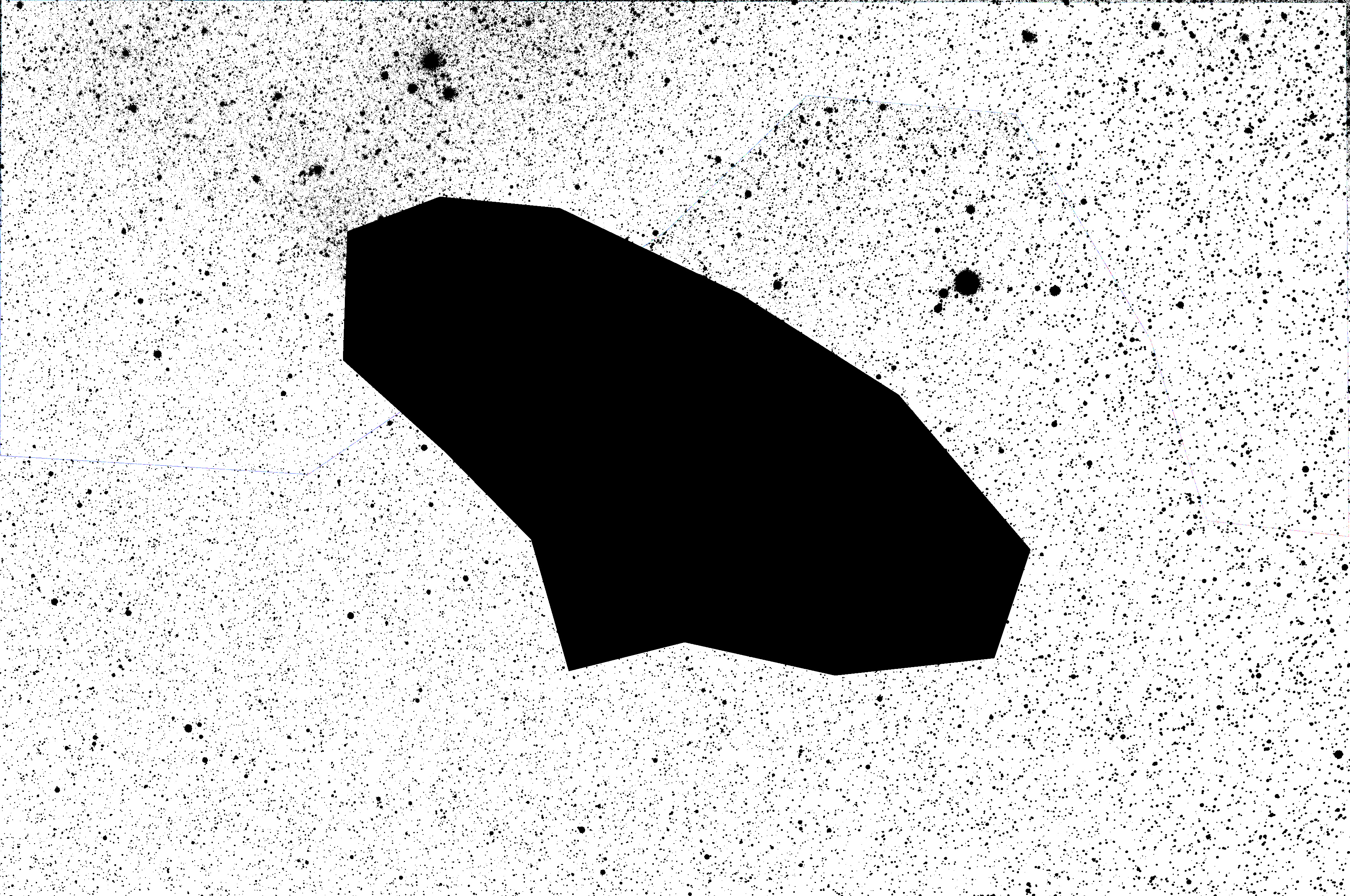

Basically, I did a Free Select around the nebula in Gimp, filled it in with white, then did a Threshold to select most of the stars, then a Value Invert to return the negative mask to basically selects the non-stars. It looks like this:

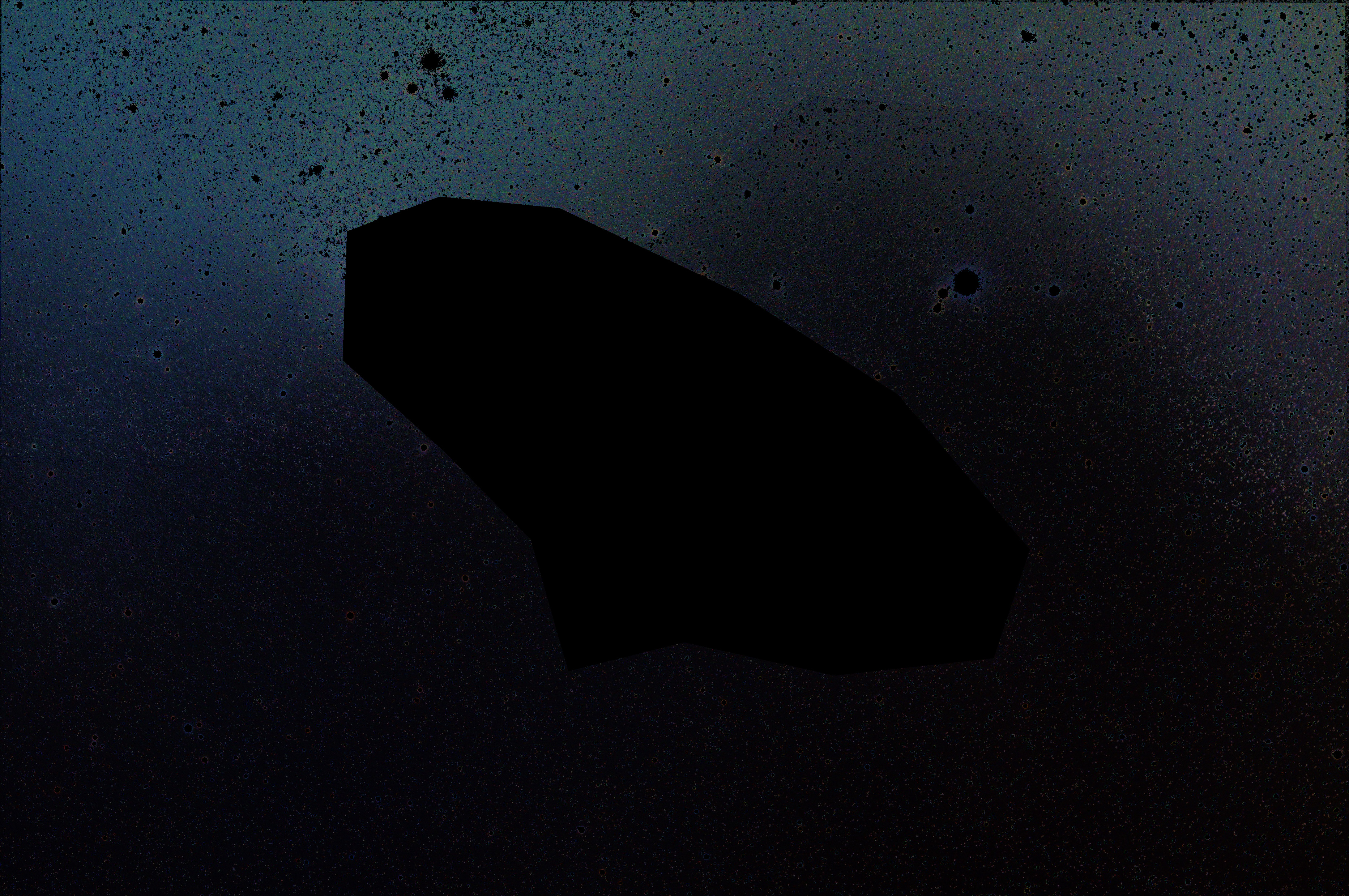

If you look closely you can see a new line introduced, this is because I did the thresholding in two steps based on the star density. The math will take the average of the non-black areas eventually so it does not affect the gradient intensity later on. The basic image for gradient estimation is obtained by multiplying the original image with this mask:

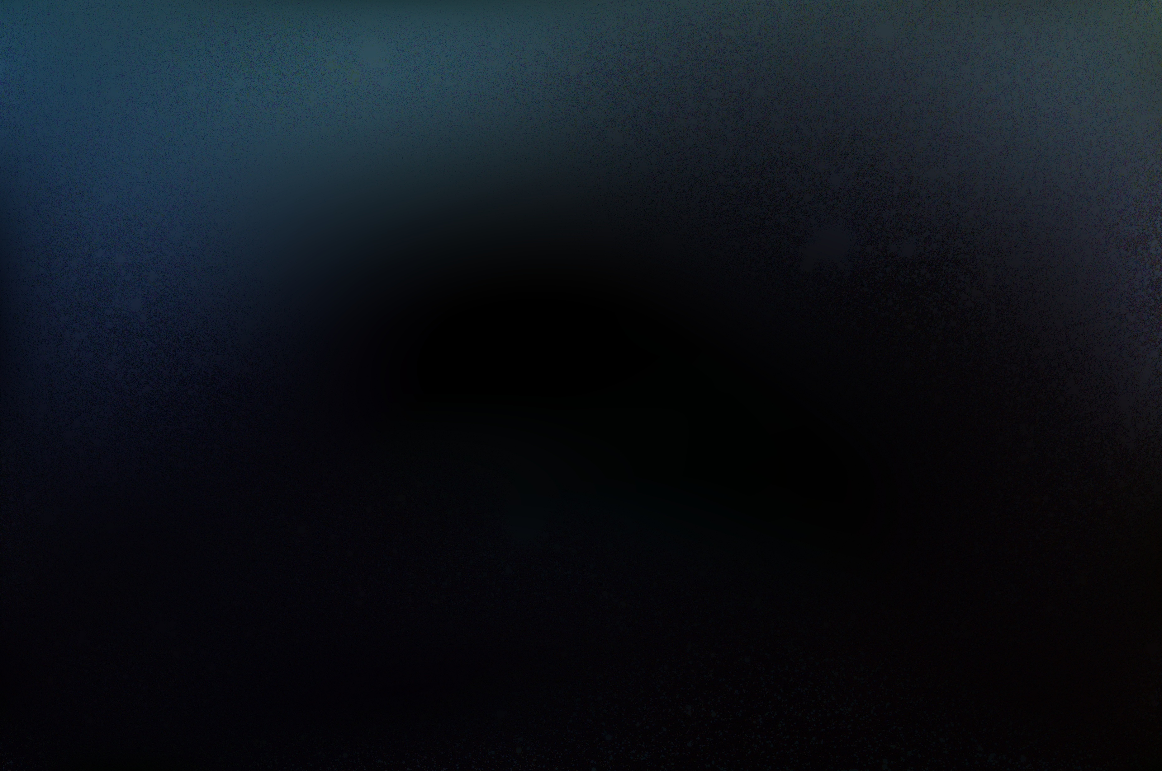

Then I ran the gradient estimator that I wrote in Scilab. It is based on a least squares estimate using Chebyshev polynomials (for numerical robustness). I tell it how many data points I want for each polynomial parameter. Based on this, it chops up the image in cells, also accounting for the blacked-out area. It collects the average data for each cell and also constructs the Chebushev regression variables for it. Then it performs a least squares for each color and composes the estimated gradient. It looks like this:
... oh shoot, 3 images is the maximum. Let me post this then continue.
 Post subject: Re: Hello all
PostPosted: Mon Nov 01, 2021 11:44 am  (#15)
Joined: Oct 30, 2021
Posts: 20
So here's the resulting estimated gradient:

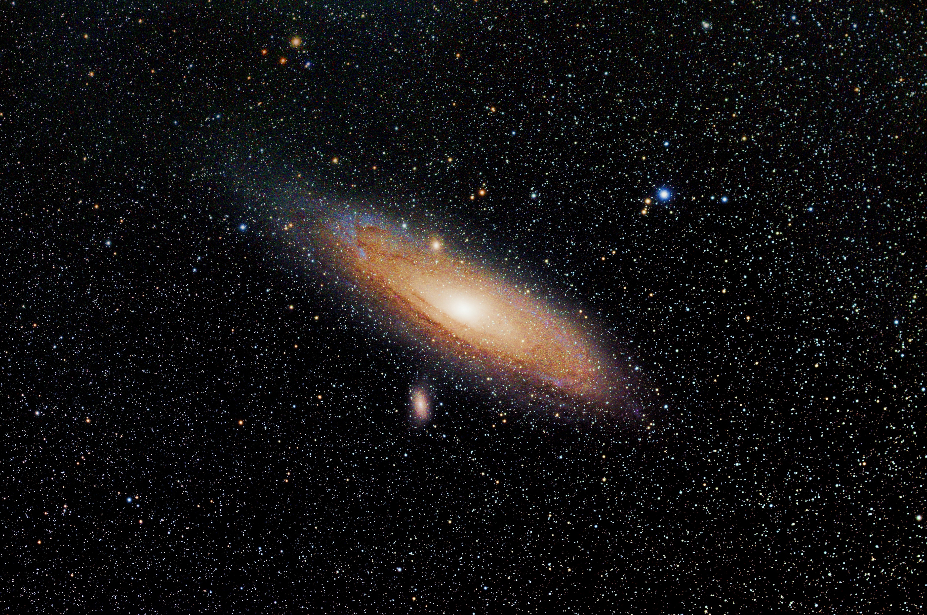

Subtracting this from the original (after maximizing the gradient to the old image to prevent negative values where the gradient values are larger than the original, I get the image with gradient removed:
This is quite nice! I don't know if this is beginner's luck but my Scilab script worked wonderfully on this example.
The reasone why I picked Scilab and not Python is because Scilab is made for math and avoids the complexities of using numpy and scipy. Furthermore, Gimp's Python does not have those anyway. I suppose I could write a Python wrapper to call Scilab from Gimp so I can keep working with the Scilab script. Let me see how this works out.

Actually I just improved it a little. In my fiirst try I included all blacked-out areas in the least squares estimation, which was unintended, and makes the gradient dive down in those areas. As a result it maintains too much nebulosity around the borders. Here's the fixed version, gradient and final image.
