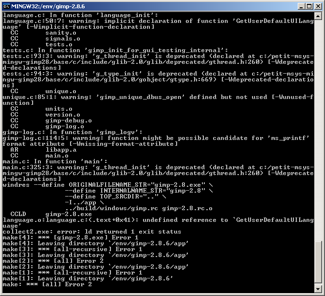

Thank you very much for your time in the museum :oops: .
My problem solved (partly)- I replaced one file (libfontconfig-1.dll) - now it works (Gimp compiled by you).
For my build Gimp this error (for makefile):
language.o:language.c:(.text+0x41): undefined reference to `GetUserDefaultUILang
uage'

@MareroQ
Site : http://meudepositodeideias.wordpress.co ... s-32-bits/
If you have an error about “Undefined GetUserDefaultUILanguage”, change line 50 in app/language.c:
//switch (GetUserDefaultUILanguage())
switch (GetUserDefaultLangID())
 Post subject: Re: Small Windows compilation environment for Gimp 2.8 32-bit
PostPosted: Sun Aug 18, 2013 1:56 pm  (#25)
Thank you for another clue - it helped.
Now it works !

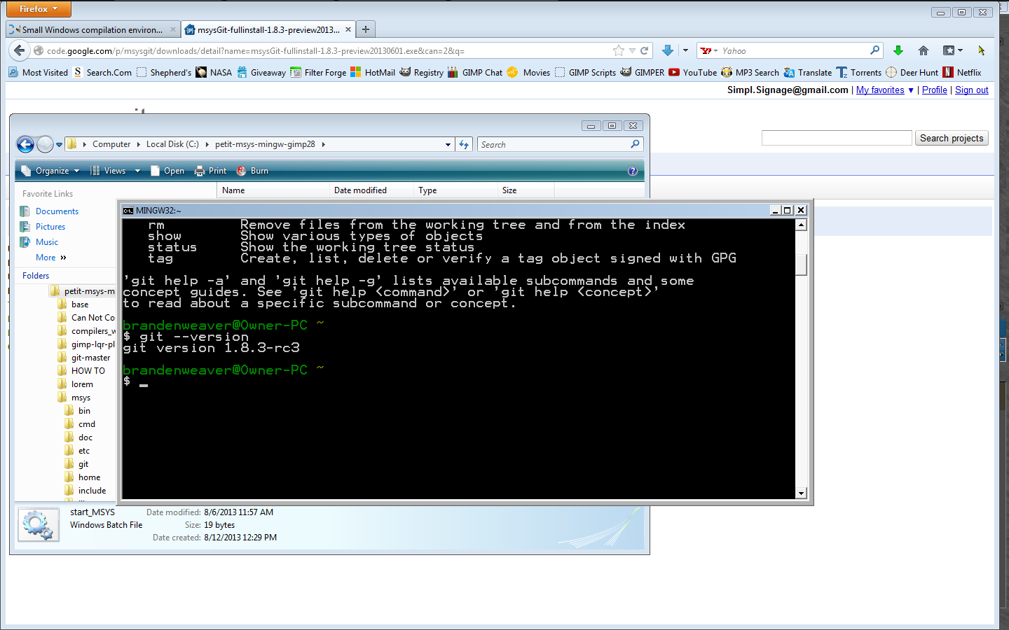

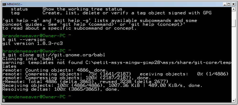

GIT is interesting to download the versions in development of programs (BABL, GEGL, Gimp, etc.).
- Some examples of commands :
git clone git://git.gnome.org/babl
git clone git://git.gnome.org/gegl
git clone git://git.gnome.org/gimp

I can't wait for the update Sam. This will be an excellent addition. I looked into GIT for Windows and msysgit but neither allow an install into Mingw that is already set up. I am interested in learning how you will accomplish this task. :bigthup
I wonder if it is possible to just install msysgit into c:\msysgit and then move all the files to the actual environment folder base/c? Would that work you think?
Or do you have to actually compile it with the current environment?

I got it! :)
PostPosted: Fri Aug 23, 2013 9:38 pm  (#38)
Posts: 16294
Test 1 for BABl at GIT. - Success! :)

PostPosted: Sat Aug 24, 2013 11:59 am  (#40)
Posts: 16294
Sam all i had to do was download the msysgit installer, install into my C:\ directory.
GIT will be compiled. This also gave me the username directory for the home folder.
Then i moved everything in the C:\msysgit\ directory sub folders into msys directory in my C:\petit-msys-mingw-gimp28\msys environment. I just made sure NOT to overwrite any of the files i had already. That worked. If you wanted to get access to GITHUB that is the way i did it.
All src files are downloaded to the C:\petit-msys-mingw-gimp28\msys\home\username directory. :bigthup
