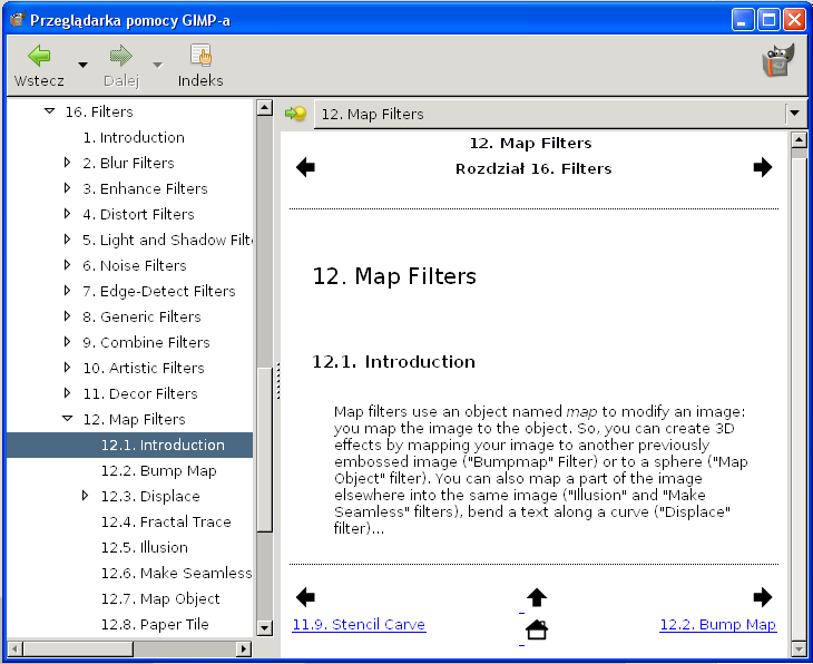

In Gimp 2.7.3 (and 2.6.11) for Windows no local browser support - You have to add 2 files:
helpbrowser.exe (in the plug-ins directory) and libgtkhtml-2-0.dll (in the bin directory) - these files are attached.
helpbrowser.zip [150.26 KiB]
Downloaded 2059 times
