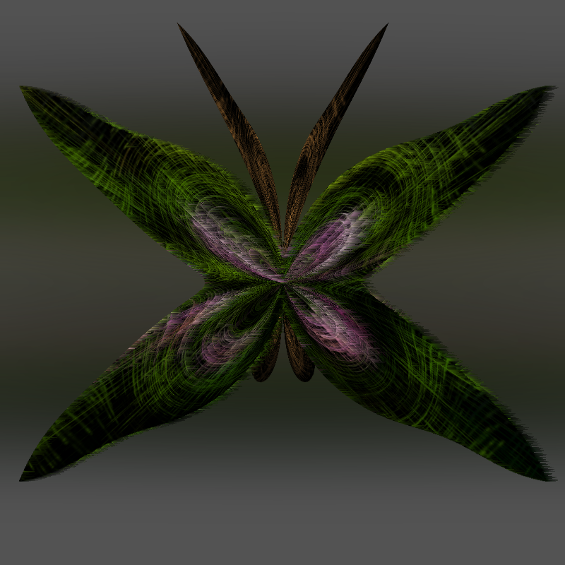

Bonjour,
To play with the plug-in "Twist", here is another script to create "butterflies" from an image.
Script-Fu butterfly_2.scm (with "Twist" plug-in version 2.1)
Filters > Distorts > Butterfly Version 2...
butterfly_2.zip [2.58 KiB]
Downloaded 249 times

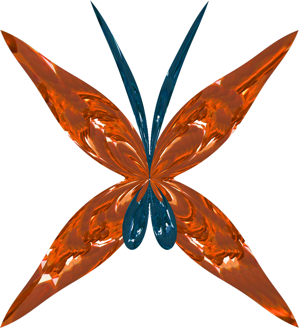

 Post subject: Re: Twist 2.1 (binaries 32-64bit Linux Windows)
PostPosted: Wed Mar 20, 2013 8:43 am  (#9)
Posts: 12870
samj wrote:
Bonjour,
Wow; definitely a keep samj. Had to do a lot of fiddling to keep the antennae from getting clipped and finally figured out how. I resized the canvas (not the fill) to a larger size and centered the fill. I then did layer to image size (forgot to add that the layer has alpha channel) before running the script-fu. Of coarse, since you separated the antennae from the wings already, I changed the colors of them to my tastes. :)
PostPosted: Wed Mar 20, 2013 9:10 am  (#10)
Posts: 12870
Just discovered that you really don't have to do the layer to image size step after you resize the canvas; the Script-fu handles the rest which is cool. I wanted broader wings for this one. :)

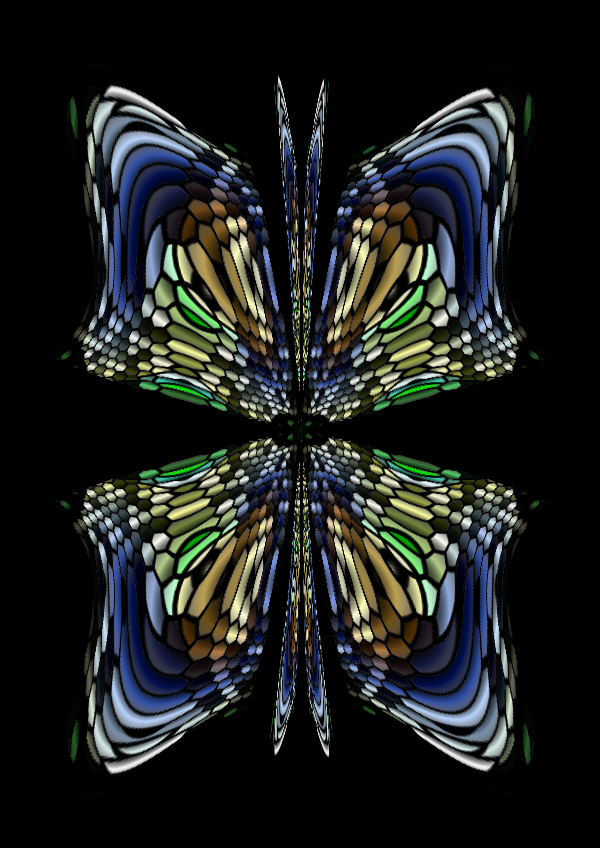

PostPosted: Wed Mar 20, 2013 12:09 pm  (#11)
Merci beaucoup !
Votre travail est très impressionnant.
