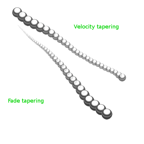

You don't realize how much you come to rely on something like that...I do a lot of detail work, and I sure miss seeing the outline of my brush. Fortunately, since I figured out the "right way" to install 2.6.11 and 2.7.2 side-by-side, I can jump back and forth if I want.
Hey Rod, maybe you should install a Linux distro and "come to the dark side." :lol
I played around with the brush dynamics for about a half-hour or so this afternoon. They can give some pretty cool effects. Here's two:
File comment: Velocity tapering and Fade tapering in 2.7.2
