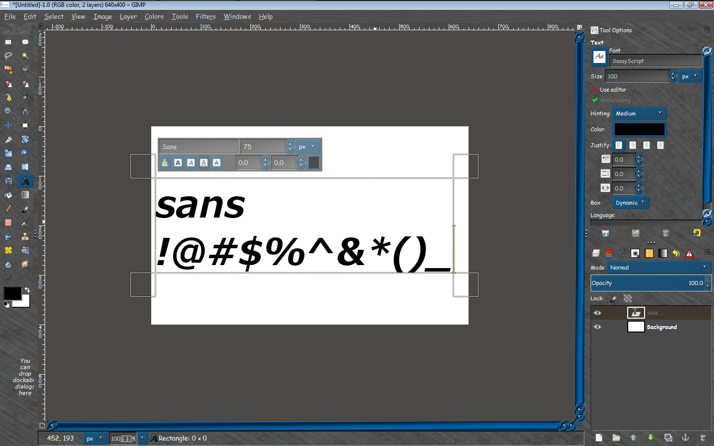

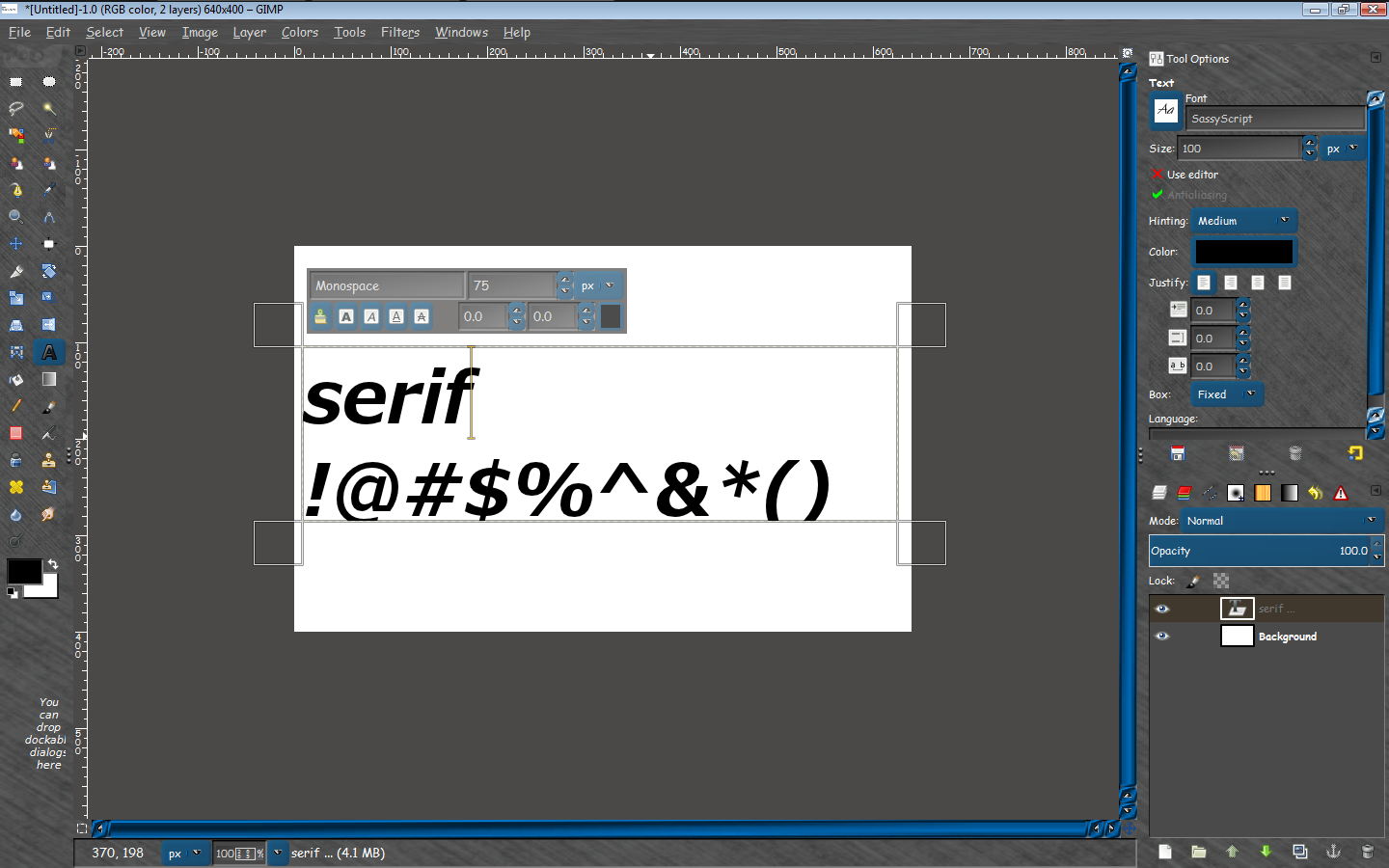

I installed this new version and noticed an oddity which might be a possible bug.
When using the Text tool, the three fonts named "Sans", "Serif" and "Monospace" seem to produce the very same result as regards the rendered characters.
Could someone else confirm this issue?

I confirm: same appearance with the three fonts you mentioned
Onkels version of Gimp-2.8.7 portable - same thing - except trying to save PNG format crashes GIMP.
Onkel you may want to fix this. :)

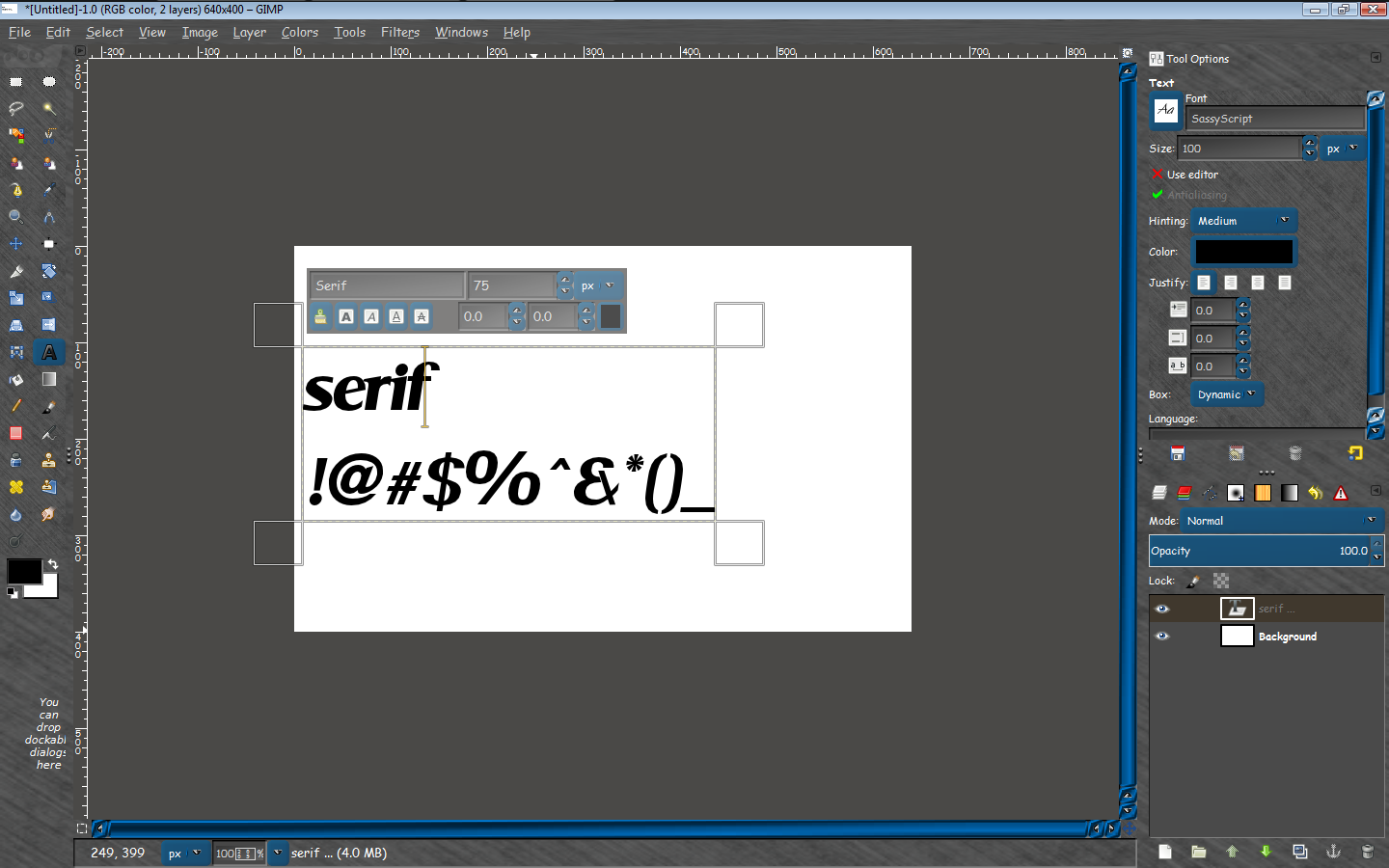

Here i have sans and monospace look alike but serif looks fine.

:lol weird now sans works. :P

The other bug with the fonts, I can reproduce. But the difference with Rod and his serif-font, where
in my version sans, monospaced and serif looks just the same, I think, it is a problem with the installed
fonts, not a problem with gimp. I don't know enough about the content of the gimp code, I only have knowledge
how to compile and sometimes find bugs, but mostly I'm not able to fix them. So: Bugzilla.
Maybe this solution will help.
Some fonts, like Sans, are shown improperly
See also the Bugzilla report
Cause:
The fontconfig package installation writes absolute paths of the building system to fonts.conf and conf.d/*.conf. When GIMP is installed on the Windows target system, these absolute paths become invalid.
Solution:
The bug should be reported to the Fontconfig developers. Meanwhile do on the Windows target system:
1. Close GIMP.
2. Edit the file <GIMP installation folder>\etc\fonts\fonts.conf:
Replace the line <include ignore_missing="yes">$a_directory/conf.d</include> by <include ignore_missing="yes">..\..\share\fontconfig\conf.avail</include>
3. Restart GIMP.

pogogogo wrote:
Cause:
Solution:
1. Close GIMP.
3. Restart GIMP.
source: Hacking:Building/Windows
Altering the font.conf file did not work for me in windows vista 32 bit. I still get the same type face for monospace and sans. serif seems okay though.
