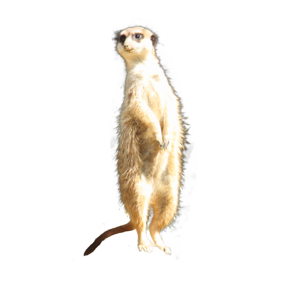

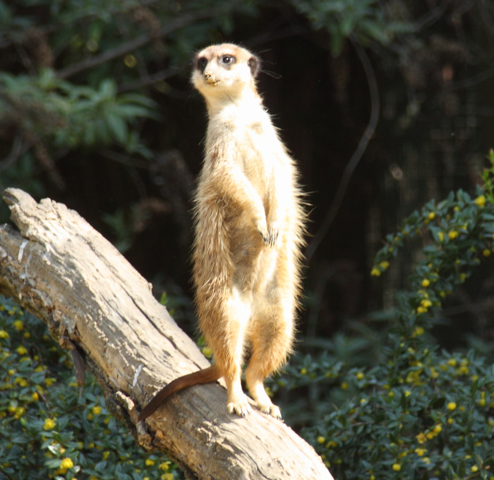

Juhuu.
Foreground select - make the forground better, make the background better, press enter.
Make a selecion mask of the result and push up the mask a little.

PostPosted: Fri Nov 16, 2012 12:44 pm  (#93)
That seems to have worked quite well.
