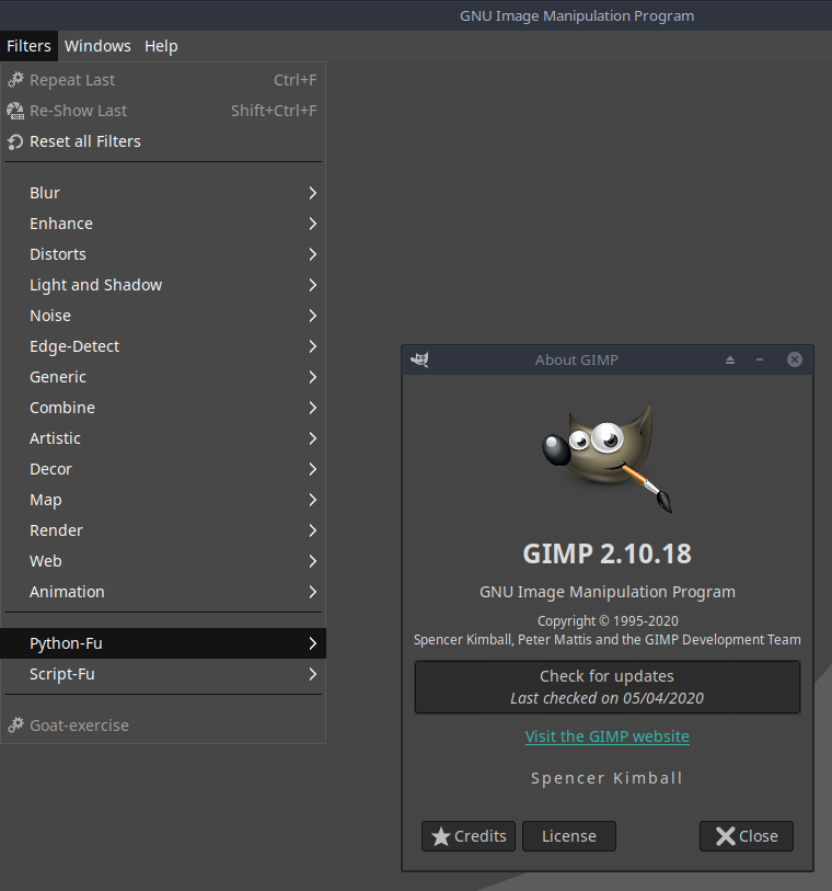

Just want to share that on MX Linux 19.1, all you have to do is to install gimp and gimp-python from the test repos.
Sweeeet, glad I didn't overwrite this HDD.

I'm guessing you're running flatpak since I don't see G'mic. Otto's is still stuck at 2.10.14, last I looked.
Nope, I would have mentioned if it was the flatpak.
There is a flatpak tab in MX package installer, but this is the normal Gimp in .config/GIMP/2.10 added from the MX Test Repo.
You didn't see G'mic, or any other plug-ins in the screenshot, because I had only added ofnuts' ofn-text-to-path.py to test out.
MX Linux is based on Debian Buster, so I added correct G'mic plug-in from the G'mic page, the one in MX repos is 2.8.4.

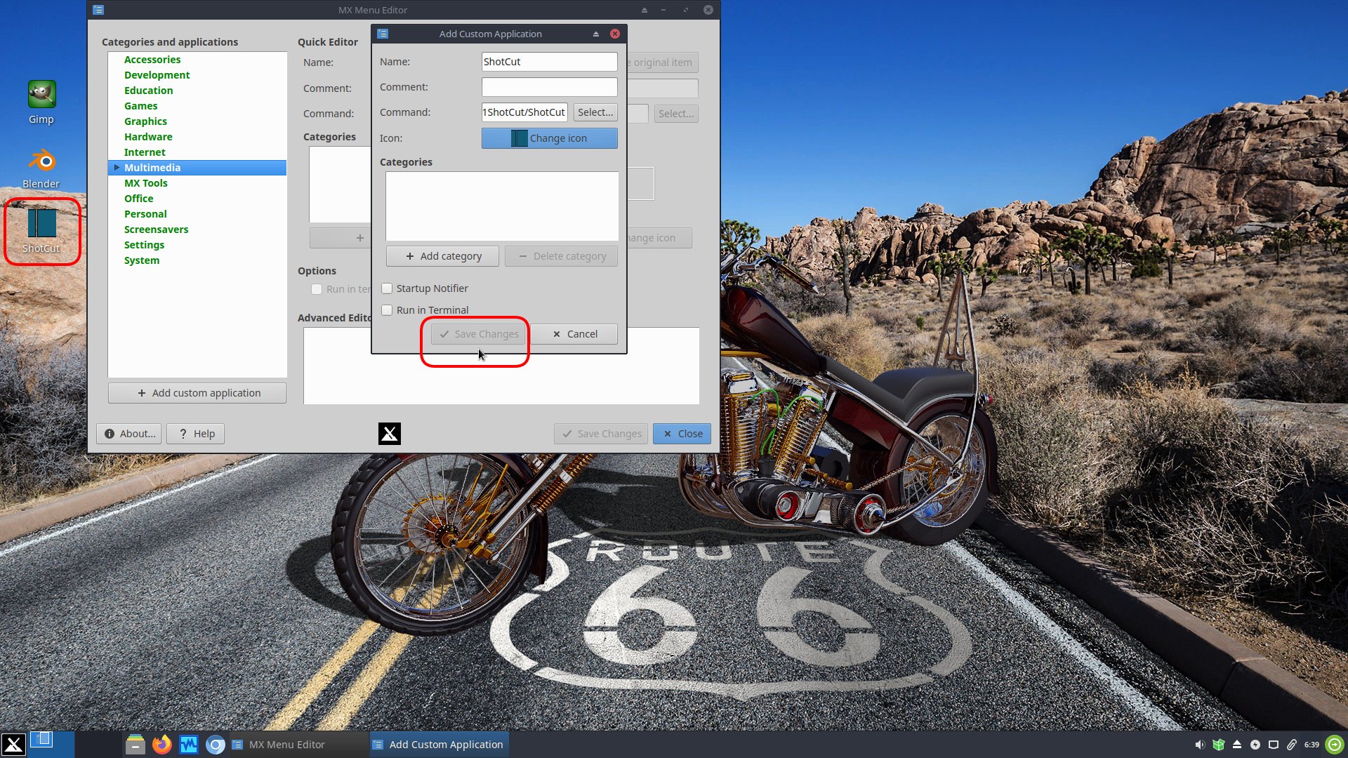

@ Nidhogg, I went ahead installed MX Linux 19.1 on my HDD (after I made a restore image of LM 19.3) and have been playing around with it. It seems OK so far, though not as smooth as LM. I've figured out how to fix most of the annoyances except the "Menu Editor". It simply is broken and won't work. I've made shortcuts on the Desktop fine, but can't make them in the Menu Editor. As you can see that the "OK" button is grayed out even though the commands work and are the same ones used in the desktop shortcuts.
Can you confirm it's not just me? Right-Click on the Start Menu button and select "Edit Applications" to enter Menu Editor.

Menu Editor, might work this way:
To add an application: https://i.imgur.com/hUp54G2.mp4
To change the launcher, right click and edit: https://i.imgur.com/nGQIW9E.mp4
 Post subject: Re: New Ubuntu 20.04 Comes With Gimp But Appimage Better?
PostPosted: Thu May 07, 2020 8:20 am  (#17)
Thanks rich2005, that did it. Apparently I needed to click "Add Category", even though I had pre-selected the category already. Oh well, learned something new.

Yeah, it was just you ;) thanks to rich2005. AntiX is great for notebooks and old hardware, got in on old Acer AspireOne.
