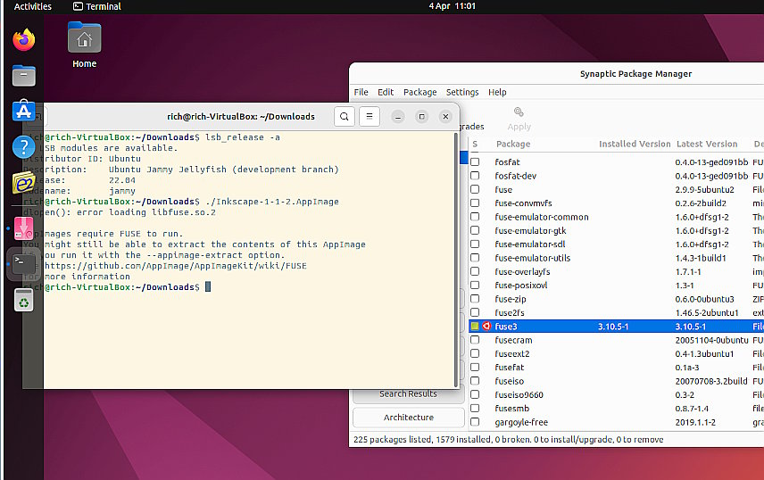

Just a reminder about 'buntu 22.04 and presumably spin-offs
Appimage (rockridge system) mounts using fuse. In particular fuse2 which is deprecated in 22.04 where fuse3 is default. You can still install fuse2.
This goes back a year, upto 3 weeks ago, worth a read
https://github.com/AppImage/AppImageKit/issues/1120

there are no issues with AppImages and fuse3 on the latest Ubuntu 22.04 jammy. They all work.
Looks that way, I did an upgrade to 22.04 (VirtualBox) and the warning message has gone. The only one I really tried is the latest Inkscape 1.1.2 appimage and that starts up ok.

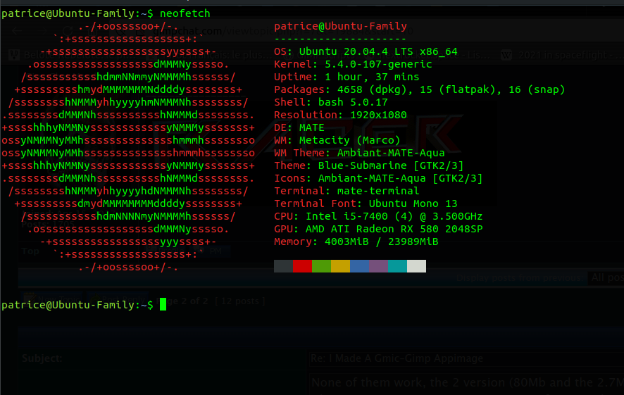

None of them work, the 2 version (80Mb and the 2.7Mb) does nothing (yes I give it the right to be executed as program)
Ubuntu-MATE 20.04, GIMP 2.10.30 PPA from Panda Jim, your appimage launched from my ~/Desktop/
