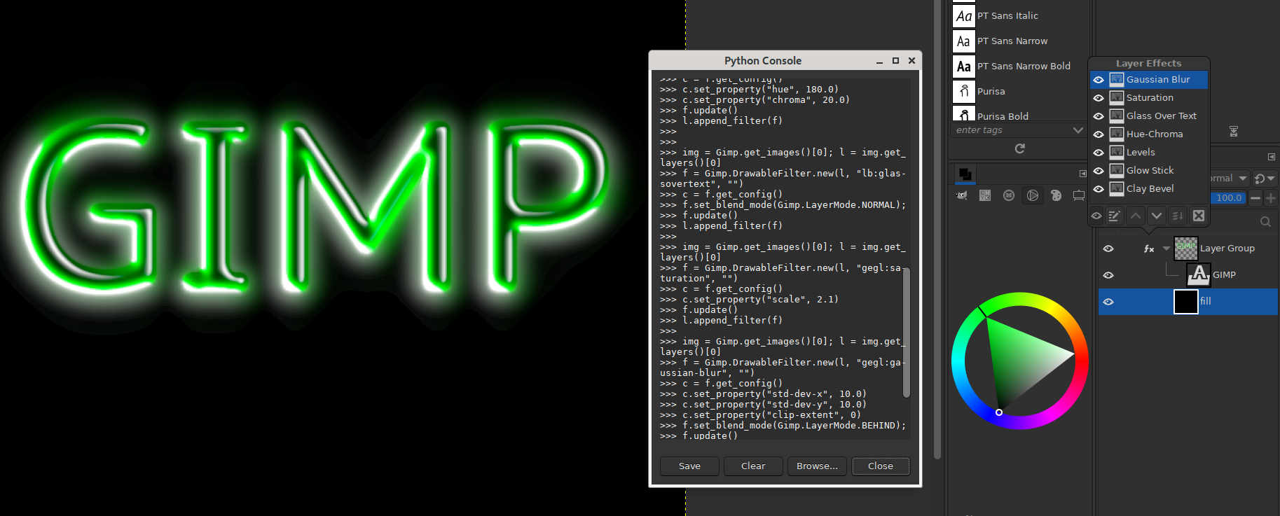

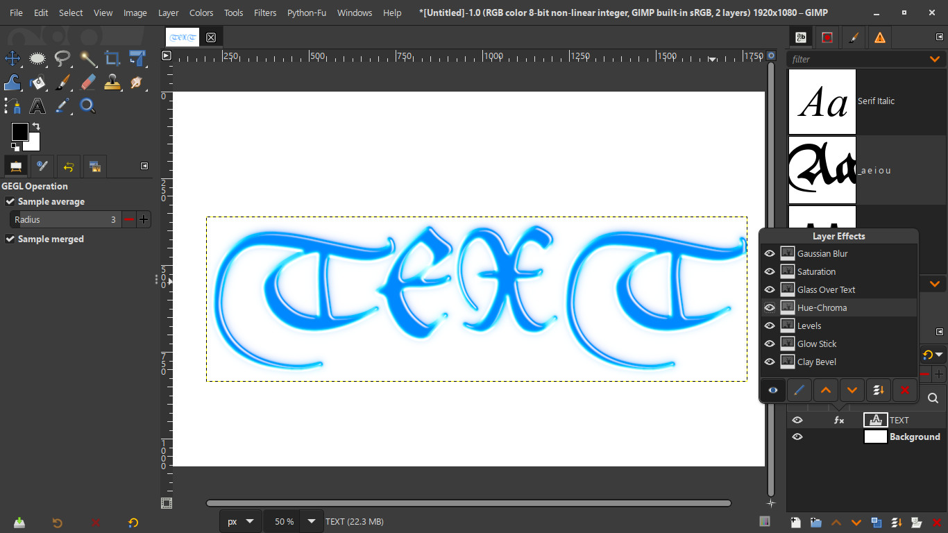

I made the first GEGL based python script using my plugins. It requires many of my plugins to work but the point is the layer effects are applied as GIMP filters as opposed to a GEGL graph.
img = Gimp.get_images()[0]; l = img.get_layers()[0]
f = Gimp.DrawableFilter.new(l, "lb:clay", "")
c = f.get_config()
c.set_property("elevation", 52.0)
f.update()
l.append_filter(f)
f = Gimp.DrawableFilter.new(l, "lb:glowstick", "")
c = f.get_config()
f.update()
l.append_filter(f)
f = Gimp.DrawableFilter.new(l, "gegl:levels", "")
c = f.get_config()
c.set_property("in-high", 0.6)
f.update()
l.append_filter(f)
f = Gimp.DrawableFilter.new(l, "gegl:hue-chroma", "")
c = f.get_config()
c.set_property("hue", 180.0)
c.set_property("chroma", 20.0)
f.update()
l.append_filter(f)
f = Gimp.DrawableFilter.new(l, "lb:glassovertext", "")
c = f.get_config()
f.set_blend_mode(Gimp.LayerMode.NORMAL);
f.update()
l.append_filter(f)
f = Gimp.DrawableFilter.new(l, "gegl:saturation", "")
c = f.get_config()
c.set_property("scale", 2.1)
f.update()
l.append_filter(f)
f = Gimp.DrawableFilter.new(l, "gegl:gaussian-blur", "")
c = f.get_config()
c.set_property("std-dev-x", 10.0)
c.set_property("std-dev-y", 10.0)
c.set_property("clip-extent", 0)
f.set_blend_mode(Gimp.LayerMode.BEHIND);
f.update()
l.append_filter(f)
c = f.get_config()
c.set_property("scale", 1.0)
f.update()
l.append_filter(f)

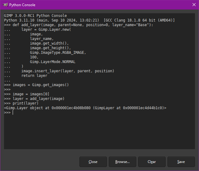

How do I make a new layer in python 3 console?
Copy and paste this function:
def add_layer(image, parent=None, position=0, layer_name="Base"):
    layer = Gimp.Layer.new(
        image,
        layer_name,
        image.get_width(),
        image.get_height(),
        Gimp.ImageType.RGBA_IMAGE,
        100,
    image.insert_layer(layer, parent, position)
    return layer
Get a list of open images:
images = Gimp.get_images()
Get the first open image:
image = images[0]
Create a layer:
layer = add_layer(image)
Charles

Its not working in GIMP 3
 Post subject: Re: GIMP 3 now has GEGL automation in python console
PostPosted: Sun Dec 22, 2024 2:36 am  (#16)
Joined: Jul 04, 2019
Posts: 282
Location: Lake Havasu City, Arizona, USA
Did the console spit out an error? It could be a problem caused by a newer Gimp version.
File comment: It works here. I created an image first.

f.update()
l.append_filter(f)
f = Gimp.DrawableFilter.new(l, "gegl:dropshadow", "")
c = f.get_config()
f.set_blend_mode(Gimp.LayerMode.REPLACE);
g = Gegl.Color.new("#000000")
c.set_property("color", g)
c.set_property("x", 0.0)
c.set_property("y", 0.0)
c.set_property("grow-radius", 7)
c.set_property("radius", 1.0)
c.set_property("opacity", 1.0)
f.update()
l.append_filter(f)
c = f.get_config()
c.set_property("x", 4.0)
c.set_property("y", 4.0)
c.set_property("grow-radius", 3)
c.set_property("radius", 9.0)
c.set_property("opacity", 0.9)
f.update()
l.append_filter(f)
