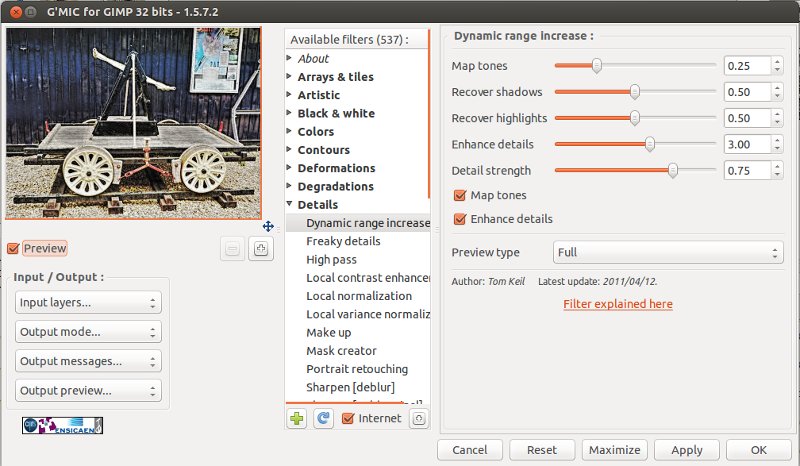

He's an idea using G'MIC | Details | Dynamic range increase.
1. New from Visible.
2. On Duplicate layer, Dynamic range increase.
3. Layer mode, Darken only.
