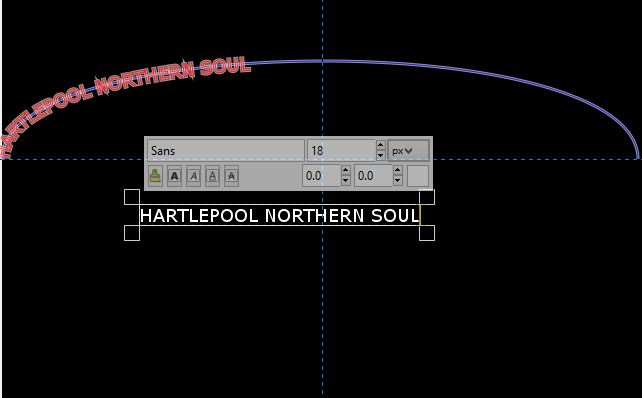

Hi all please excuse my ignorance, I`m pretty new to all this, but I`m learning all the time. I`m trying to text along an arch as my image, but as you see, my text is all on one end, if I make the text bigger, I lose my text outside my new project. Can someone give me some help in how to get the text along the arch??. Many thanks for any help you can give me. Have a lovely day :)
You can try Ofnuts text-along-path script (http://gimp-path-tools.sourceforge.net/tools.shtml#text-along-path) .
Then, select:
Centered / Baseline options.
bbbbbbbbbbbImage
 Post subject: Re: circular path - what am i doing wrong?
PostPosted: Fri Jul 25, 2014 7:28 am  (#7)
1) the regular "text-along-path" function doesn't center the text, it is always left-aligned. My scrpit (see above) lets you center the text, among other things
2) some early Gimp 2.8 releases truncate the text. Fixed since 2.8.8, IIRC.
Thanks very much for your help, can`t see a download for windows 8? and can you advice which file in gimp to put once downloaded. Once again many thanks for your help :)
