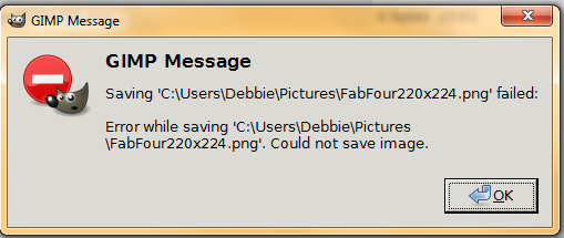

Not sure why I would be getting this as normally I have no problems.

Try exporting your png instead of saving. You can save an XCF, but not anything else.
Saving vs exporting in Gimp
This change was made when Gimp-2.8 came out

'Could not save image' is actually a message from the file-png module... Hard to tell the cause, but normally some other errors (like directory/file not writable) have their own message. This message will most likely occur when the back-end library gets confused while writing to the file. Is the disk close to full?

Thanks Molly....I was trying to export :D

Can you try the menu option: Image/Mode/Assign Color Profile and select RGB Workspace, click Assign, then try saving?
If that doesn't work, you could try: Image/Mode/Covert Color Profile, select RGB Workspace and click Convert.
I've ran into problems with PNGs that wouldn't save because there was an issue with their color profile.
