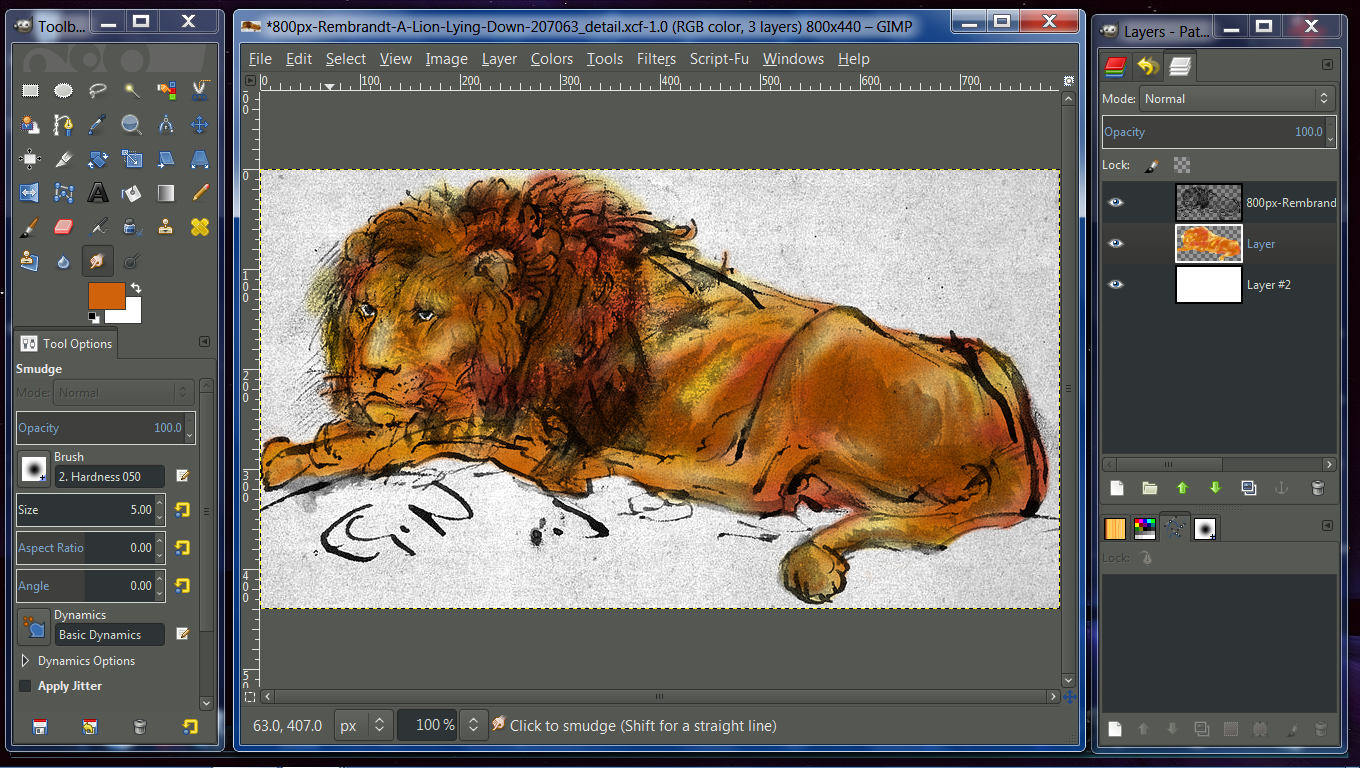

I wanted to color the sketches with GIMP but I was too hard to get an actual outline. What I wanted to do was to get outlines of the drawing as guides for the color but the Wand Tool is too sensitive and it even selected the deepness of the drawing and some sketchmarks. I drew this in paper (the image attached is not really mine) but it looks like it when drawn in a piece of paper. I did make some larger more bolder marks to the drawn and traced it with another paper but it does not seem easy to do. I tried adjust the composite and threshold but I can't get the outline. I tried tracing it but there are too many curves and spikes and it was a pain to do. I need to get the speed because I have to draw a lot of them, that's part of a project.
This is not the image but its here to give you an idea. Rembrant's Lion :paint

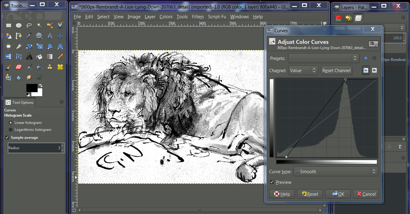

An alternative method would be to Desaturate with Luminosity as did he4rty, but in this case adjusting Color Curves and doing a Color To Alpha on the white.
Desaturation...
Curves Adjustment...
Color To Alpha...
Final Workable Image...
This method will retain most of the image details.

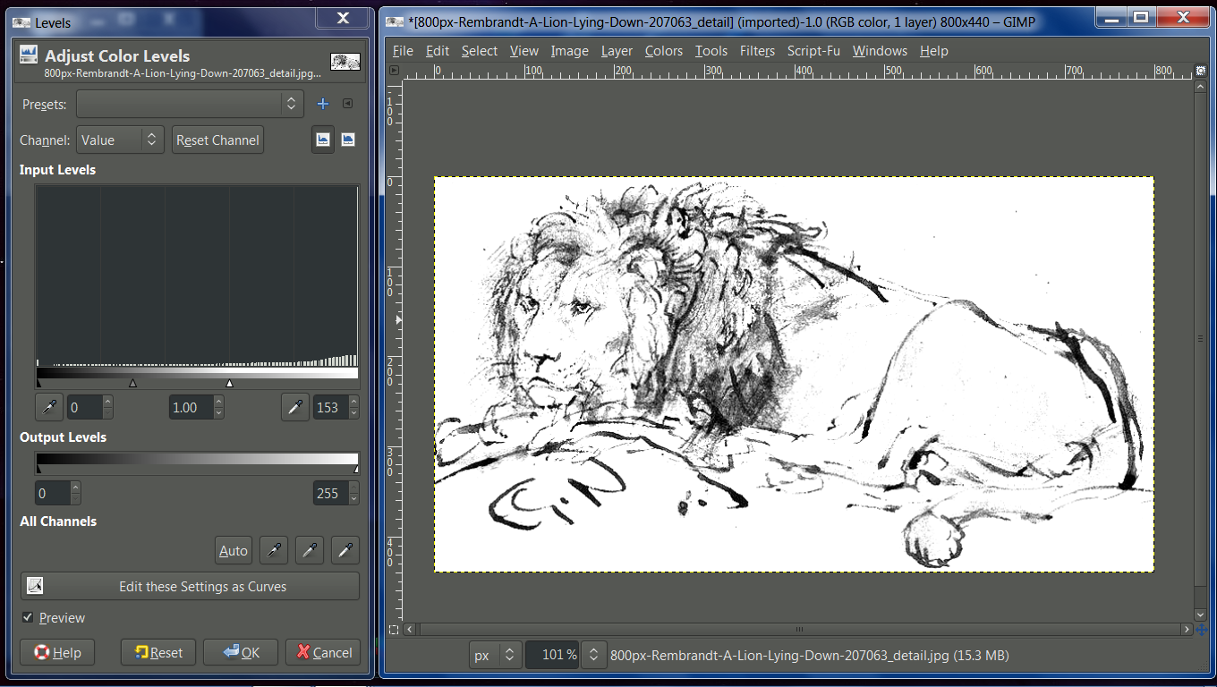

What I suggested does not include using G'Mic. I'm also not entirely sure what you're asking.
If you wish to remove some of the shading that is in the image, you can use Color>Levels to adjust the image as you see fit.
The levels adjustment is done prior to the Alpha to Color of the white. Once you have adjusted the levels you can do the Alpha to Color of the white.
Here's an example of Levels before doing the Alpha to Color of the white...
Before using Levels
After using Levels
I would also suggest that you use the Free Selection Tool :freesel to make a selection of the lion's mane. Cut the selection and paste it into a newly created layer as seen below.
