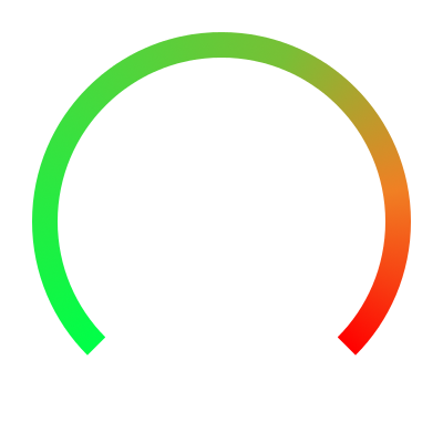

Do you mean something like this?

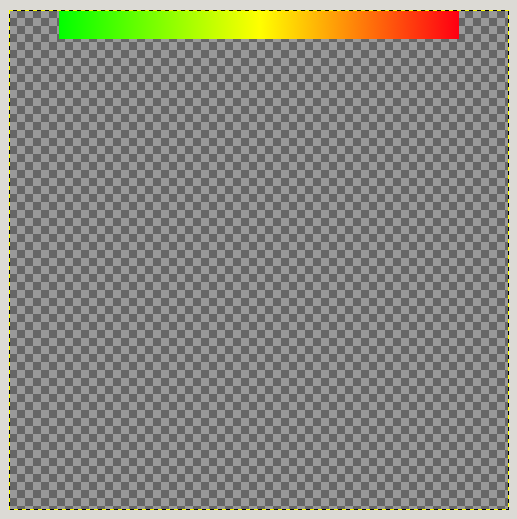

Instead of using Curve Bend, try using Polar Coordinates to bend your rectangle. Note how the rectangle is located on its layer.
I think that this is the quickest way to do this, but it looks very jagged along the edge. Much more so than the one I made without using Polar Coordinates.
Is this what's being asked for anyway?
