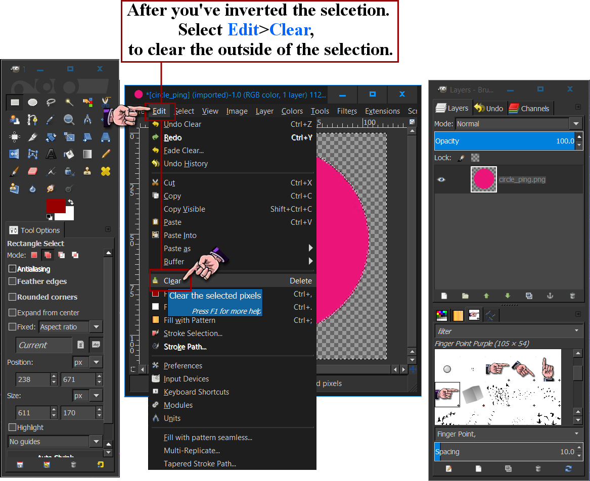

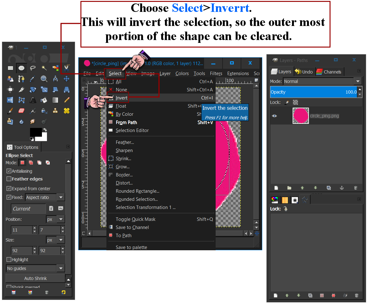

NOTE
The method shown above,
can be the simplest way to do this,
but it isn't always the best way.
The method as described by Ofnuts,
will most often give you the best results.
However,
working with paths can be difficult for new Gimp users.
Nonetheless,
I do encourage you to explore the use of the Paths Tool whenever possible.
