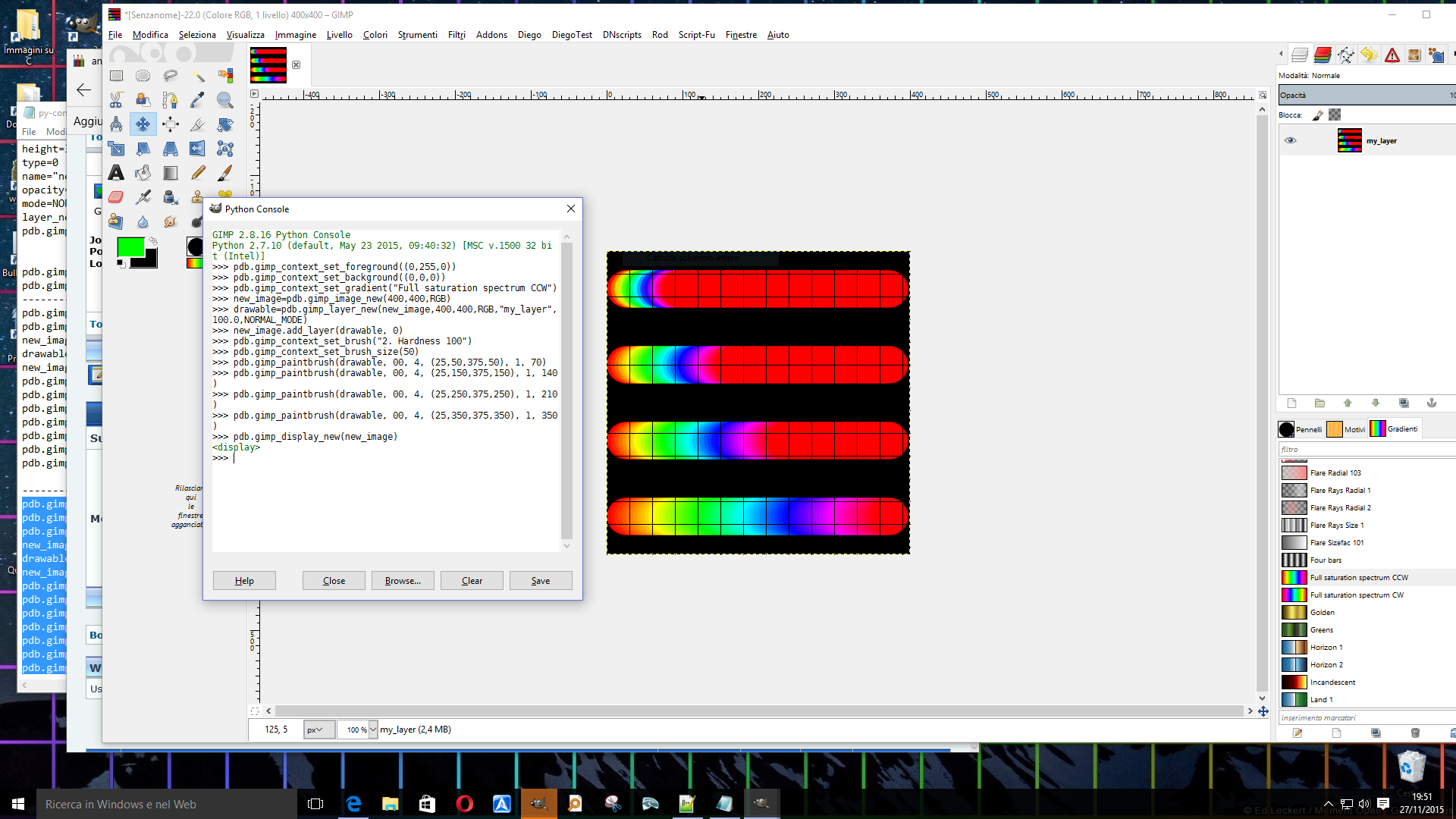

and there is also another oddity:
if the option to use the gradient is chosen it seems that the stroke goes "naturally" from the first point to the last (left to right) as opposed to the behavior discussed previously
so, in the same filter the same parameter (the array of strokes) is interpreted in opposite ways when using the "fading" and when using the gradient.
(the result is the same both using method 0 and method 1 -BTW I do not understand when and how this parameter is taken into account-)
another aspect (in the use of the gradient) is the behaviour at the end of the "space" indicated by the user for the gradient span: the last colour is then repeated indefinitely, while it could be nice to see the gradient be repeated; maybe also this one is something "historical", but not "nice" per se
