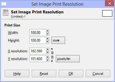

Go to Image>>Print Size
Break the chain linking X resolution and Y resolution
Set the Width and Height to 100 mm
Then Choose mm as your units on the main window
Your cursor location with then show 0 - 100 across the image.
