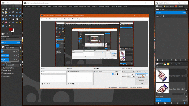

As I said in the title I suddenly lost the toolbox. I did an unvoluntary move with the mouse and the toolbox vanished. In other words, I have no longer the left column.
I tried to recover it by deleting the «sessionrc» but to no avail.
I am using the three windows method.
I suppose the picture show enough of the problem and i trust, the German version is no problem.
I hope somebody can give me a solutions else I would probably have to delete all and reinstall.

You can check this video I made.
To see if it helps.
Also,
if you click on the Tool Options Tab and drag it off the dock.
The Tool Box should reappear.
Then drag the Tool Options Tab back,
into the empty space below,
where the tool icons are.

Thanks Wallace, that is all I needed. All in the Green again.
