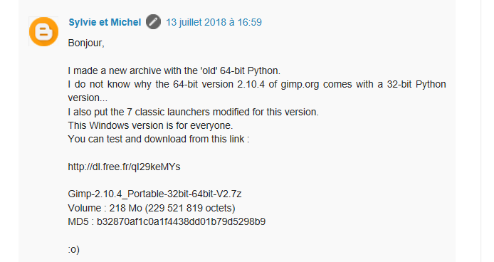

PostPosted: Mon Jul 16, 2018 12:36 am  (#18)
Pat, use the very last pack, it says 2.10.4
Download it from http://dl.free.fr/ql29keMYs

 Post subject: Re: Bevel Reflect Logo
PostPosted: Mon Jul 16, 2018 12:46 am  (#20)
Do you see the "commentaires" on samj's blog?
edit: there are 9 commentaires, this one is the 7th. in the list.
If so, double-check the address, it should be valid for one month.
