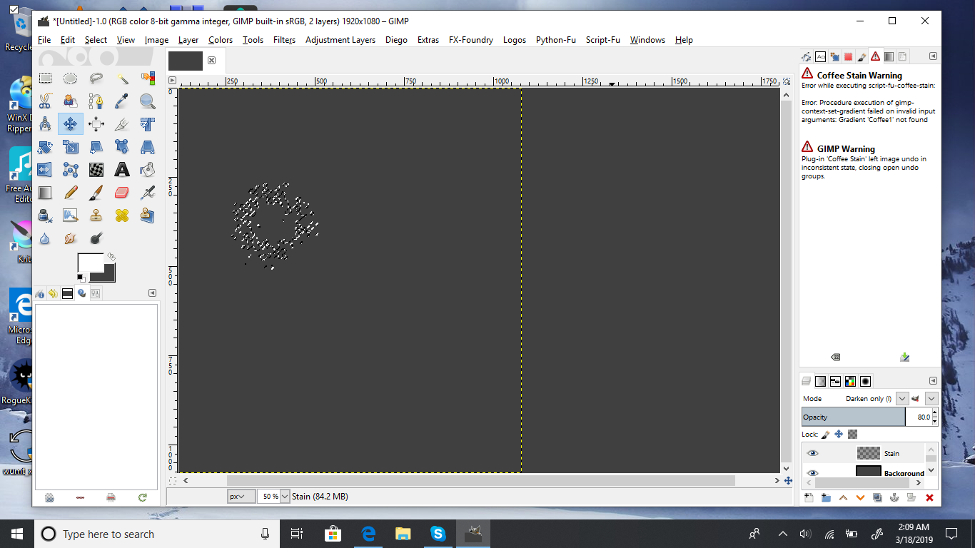

The coffee stain script under tools gives me an error.
