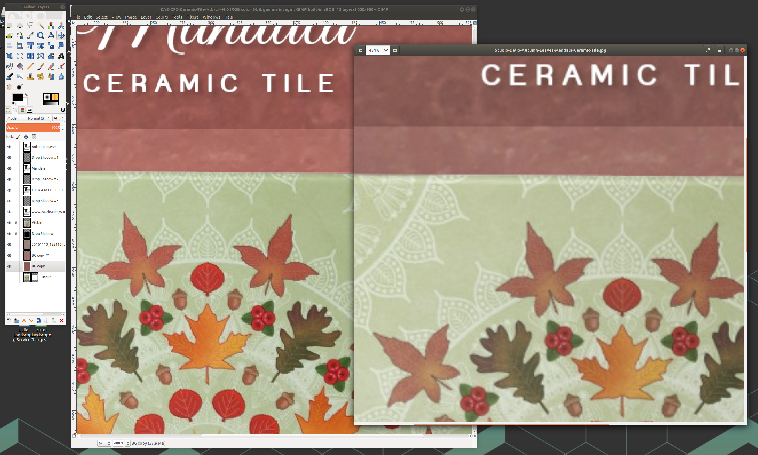

I have recently noticed that the colors of an image look much more vibrant in GIMP than they do in any output file (jpg, png). The attached file shows GIMP on the left and a jpg of the same image on the right. Note that the colors in this screenshot are duller than they were when I created this screenshot in GIMP.
Has anyone else noticed this? Any ideas what's going on here? I really need the color in my output files to look like what I see inside of GIMP.

OK, after poking around for a bit I found a reference to GIMP's color management which I eventually found in the Preferences dialog. When I check "Try to use the system monitor profile", the color inside of GIMP becomes the color I see in the raster files. I got a new BenQ monitor recently, so I guess that changed something about the way colors work for me in GIMP.
