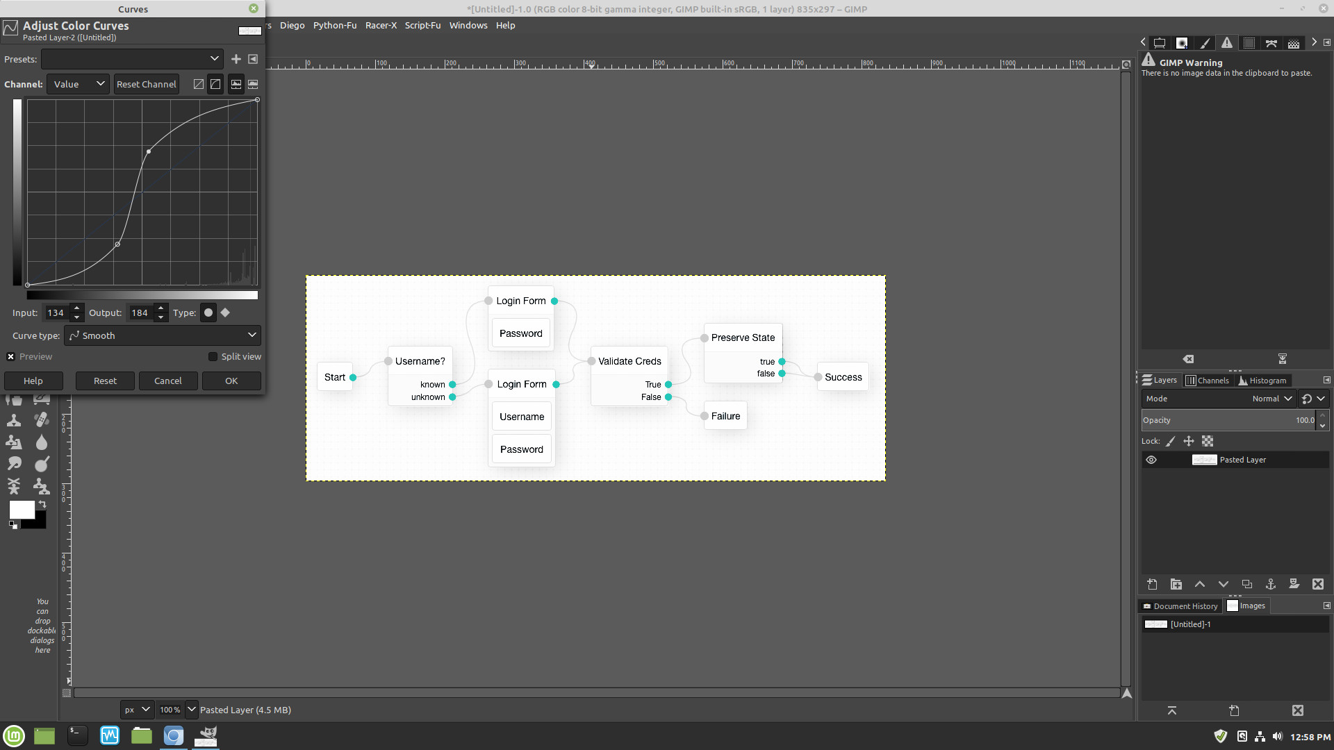

...........Or just use the Curves tool and do it in a couple of seconds.

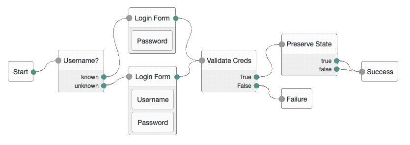

clean-image.zip [1.04 KiB]
Downloaded 156 times
This script works on my gimp 2.8.22, located at "<Image>/On test/Clean image"
Running the script on your original image gives the first image below
The second image is 10-15 minutes tidying up the top layer
The third image is after another 10-15 minutes of painting black on the mask to allow the insides of the boxes to show through
Hope it works/helps, though racer-x curves looks the way to go
Steve

Third image
