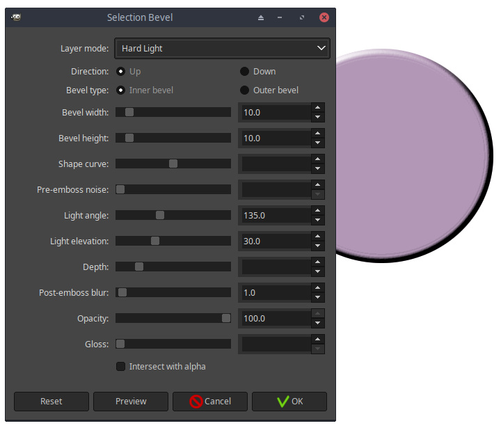

The bevel that was used is in the tut is Selection Bevel 2.3 by DD.
I've attached it.
You can use the new GEGL displace, even it is different from the old one.
I think Abyss Policy "Loop" in 2.10 is same as the "Warp" Edge Behavior was in 2.8
bevel2_3.py.zip [5.76 KiB]
Downloaded 226 times

Thanks to all 3 :)
Konstantin,I'm going to go look at your link.
Nidhogg,thank you for Bevel 2_3 :) and for "I think Abyss Policy "Loop" in 2.10 is same as the "Warp" Edge Behavior was in 2.8"
