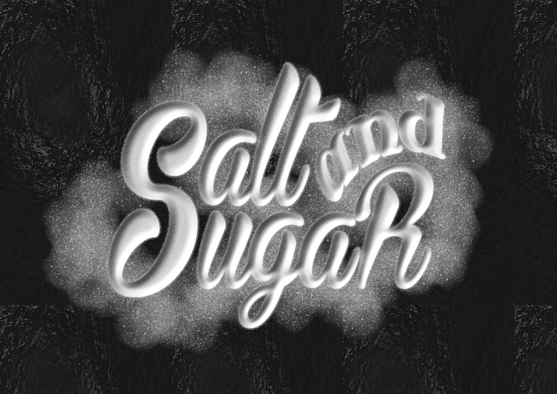

Does anyone have an idea to create something like this?
I once used this with Adobe photoshop.
If it's a brush I'm already satisfied

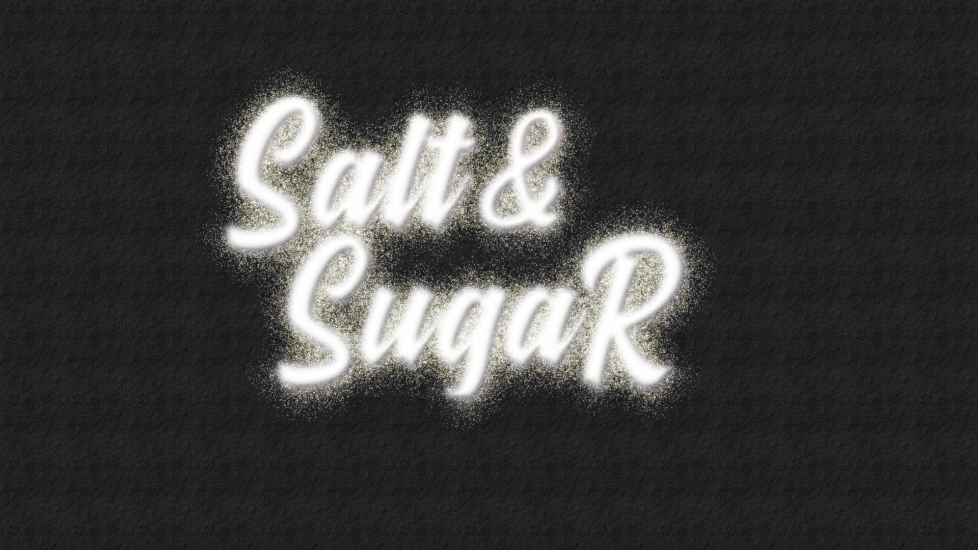

You can use Filters > Noise > Spread.

How stupid of me...didn't think of that at all...thank you!

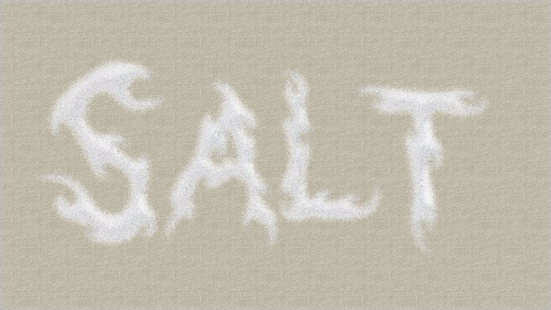

Used a diamond dust pattern, and masked with rose template I have. I then ran Local Orientation on just the mask and merged that result with the diamond dust to give it some dimension. Then noise spread the result and desaturated. Still not piled enough for my taste but if it wasn't 2:28am my time, I might come up with a better solution. lol
