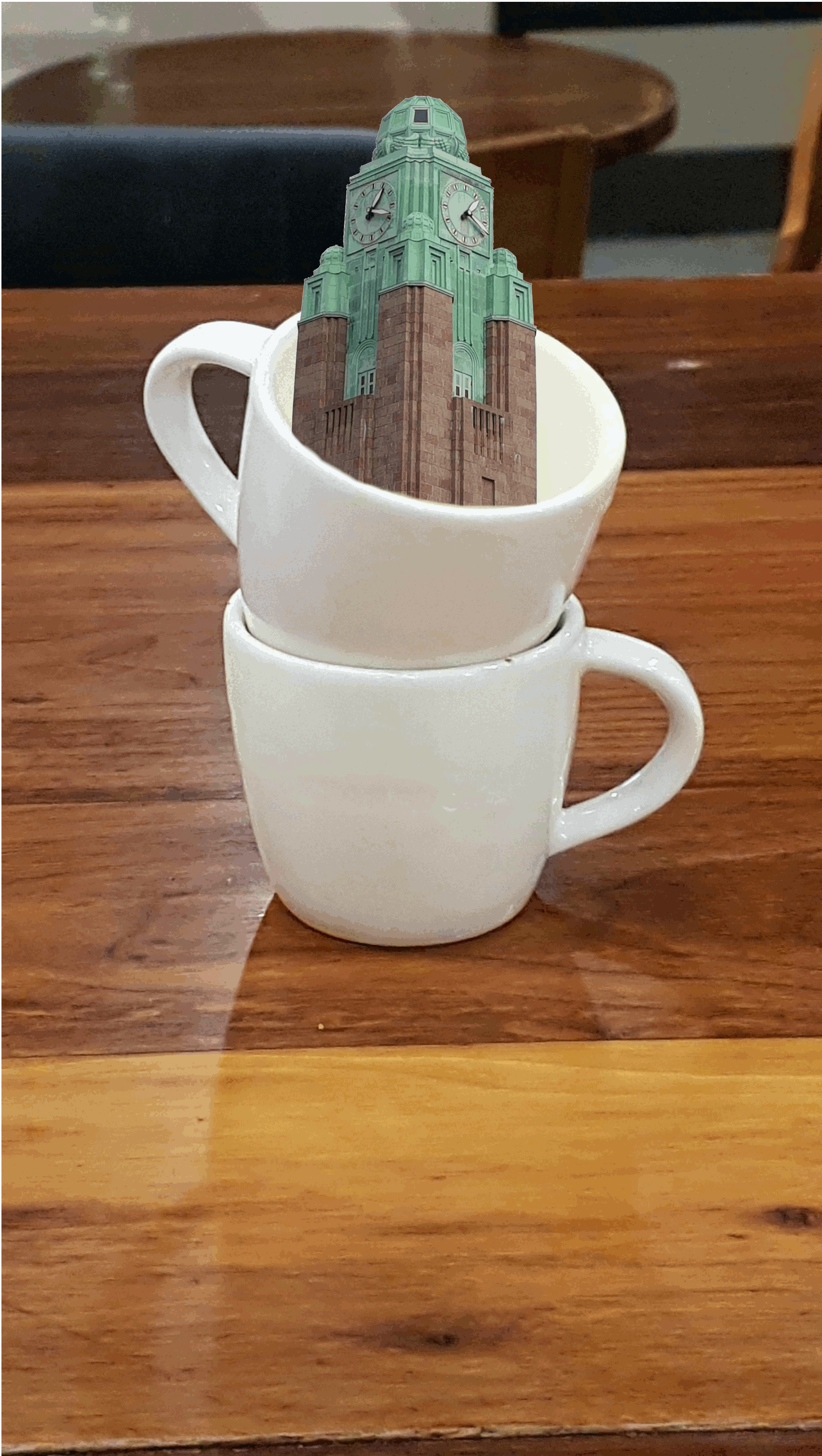

I want the clock tower to come out of the coffee cup.
I made a layer mask, so that I could paint out the lower part of the tower.
what I found was the the lip of the cup, which is a perfect ellipse, is very hard to paint. It looks bad.
but I know GIMP has an ellipse selection tool.
Is there a way to place the ellipse around the lower part of the tower
then turn it at an angle
then erase the part we don't want
to exactly match the lip of the cup?

Position your tower as you want it first. Make sure you only have the 'tower' layer mask selected and you should be able to do it.
Make your selection so it goes along the cup lip and right around the tower, fill your selection in with colour white if using a black (fully transparent) mask
I did a simple mortar and pestle out of the cup in g'mic, using a mask.

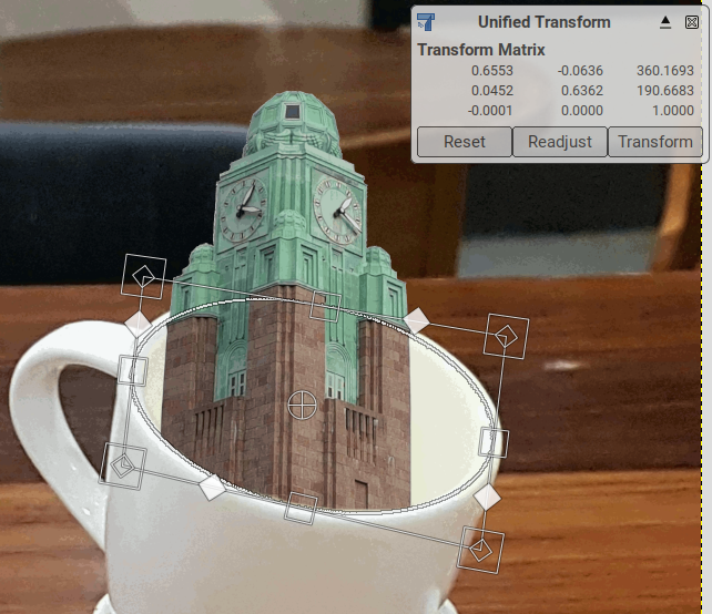

YOU CERTAINLY DON'T WANT A PERFECT ELLIPSE BECAUSE THERE IS SOME PERSPECTIVE IN THE CUP. THIS SAID:
  • CREATE AN ELLIPSE SELECTION ROUGHLY WHERE YOU WANT IT
  • USE THE UNIFIED TRANSFORM TOOL IN "TRANSFORM: SELECTION" MODE (RED SQUARE ICON) TO TWEAK YOUR ELLIPSE AND ADJUST IT TO THE LIP OF THE CUP. YOU MAY HAVE TO DE-SELECT SOME "CONSTRAIN" SETTINGS IN THE TOOL (SCALE, ETC...).
  • WHEN HAPPY WITH THE FIT, "COMMIT" THE TRANSFORM .
