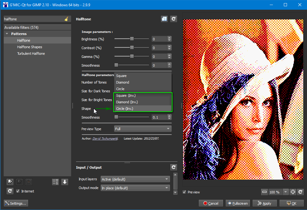

The best :bigthup

Not sure that the OP is speaking about the same things as you... Also not sure why G'MIC did put "(Inv)" (maybe it means "Invert") as it is not the "Inverse" that I think the OP is speaking about...

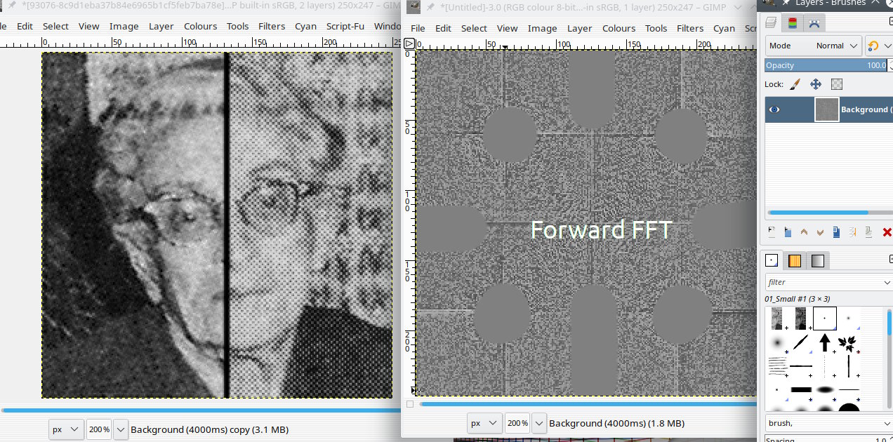

anti-halftoning is removing the half tone pattern, sometimes called de-screening.
The gmic_gimp_qt plugin has descreening filters.

Another way is use a fast-fourier-transform (FFT) plugin. There is one in gmic but I prefer the standalone plugin.

Thank you all very much. The discussion was helpful. "Inverse halftone" is just halftone to continuous tone.
Gmic -> test -> ian ferguson -> descreen worked well.
